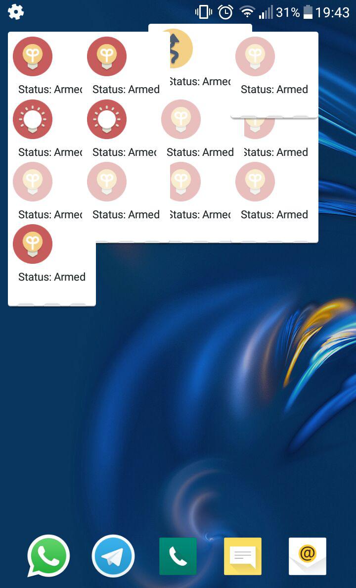

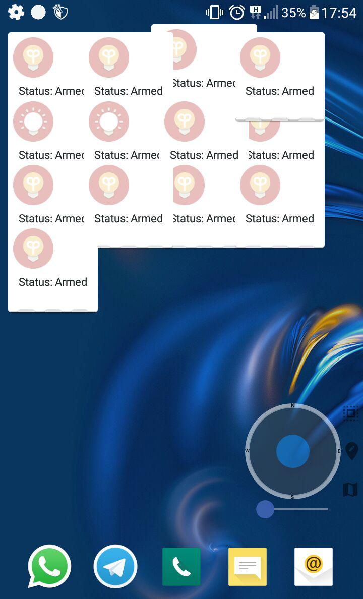

PSYCHOTIC
- Posts: 20
- Joined: Saturday 21 February 2015 16:32
- Target OS: Windows
Re: Domoticz app 2.0
Please fix the widgets i keep having problems with them.
All the below widgets are switches now they have the alarm status..
Thx
After a reboot they look different...
Thx
- widgeterr4.jpg (76.32 KiB) Viewed 3746 times
- widgeterr3.jpg (77.4 KiB) Viewed 3749 times

PSYCHOTIC
- Posts: 20
PSYCHOTIC wrote:Please fix the widgets i keep having problems with them.![]()
All the below widgets are switches now they have the alarm status..![]()
Thx
Guys any update on how to fix this ?
