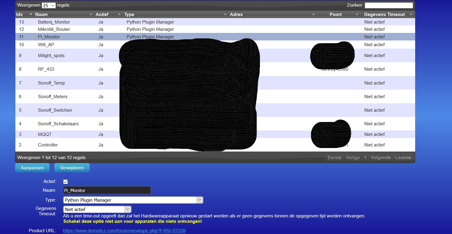

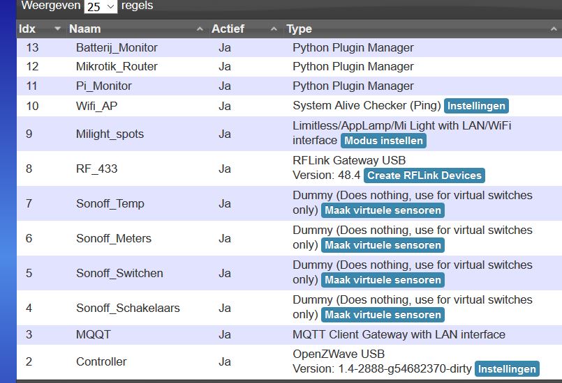

Posts: 230
Joined: Saturday 21 July 2018 19:03
Location: Home@Belgium
Re: Python Plugin: Python Plugin Manager
Post by Gianni »
read this topic but did not find a solution
Installed pp manager without problems
Install plugins without problems
get a message device created
but under devices there are no new devices to find?
I cannot chance te plugin settings.
log show that everything is correct
Reboot my domoticz multiple time.
my log

1 thing i did not find is the update button i only have a add button
ycahome
Posts: 248
Joined: Sunday 12 February 2017 10:55
Domoticz version: lat Beta
Post by ycahome »
Gianni wrote: Saturday 30 March 2019 2:14 read this topic but did not find a solution
Read the very first post of this thread.
You made the most common mistake. Multiple installations of PP-Manager.
You should install once and only pressing update for every plugin you want to install.
Gianni
Posts: 230
Post by Gianni »
ycahome wrote: Saturday 30 March 2019 7:27 Read the very first post of this thread.
i know that this is the problem :lol:
But like i say where can i find the update button?
Gianni
Posts: 230
Post by Gianni »
never mind found the update by putting my language to english :-)
but i'm feel like a blond woman now :-(
so i select pp manager --> give it a name -->and add a dummy plugin.
Then i got 1 instance off pp manager in my hardware screen
Then is select in the hardware window the pp manager.
Then is select for example pi monitor.
Then i hit update but the only thing that changes dummy plugin to pi monitor but no extra hardware nor a new device?
:oops: :oops:
