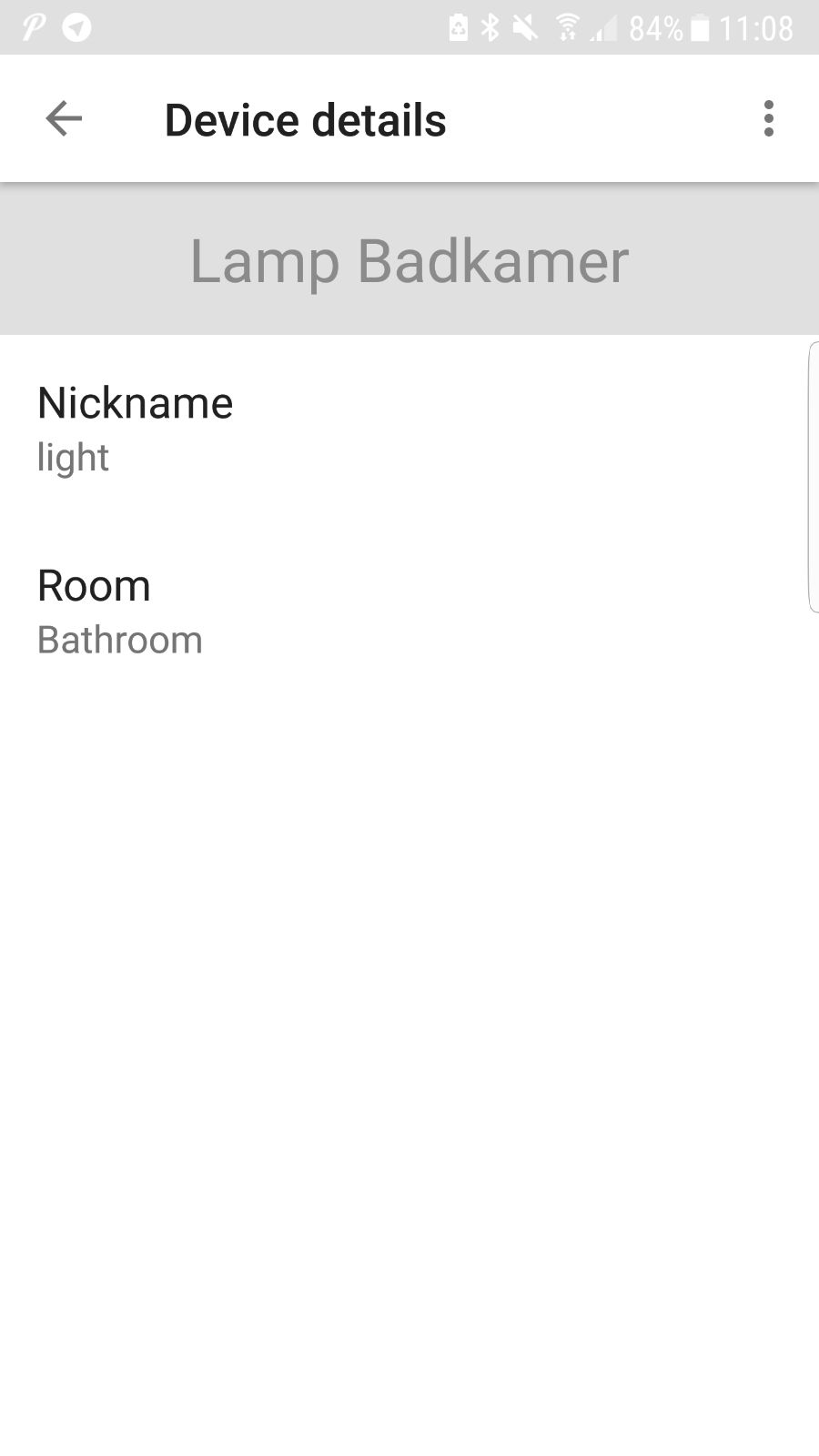

Mmm
Devices available in multiple domoticz roomplans, check
Setup of controlicz, check
Devices available in controlicz, check
Google Home App connected to controlicz, check
Devices appear in google home app, check
Devices (nickname given) and added to a room in google home, check.
WhatsApp Image 2018-04-27 at 11.15.26.jpeg (31.27 KiB) Viewed 2487 times
"Hey Google, turn the light on in the Bathroom".
-> "Sorry I don't understand".
Some pointers in the right directions from the forum experts please :lol: to get it up and running.

sincze wrote: Friday 27 April 2018 11:20 Mmm
Is your Google Home app running as UK English? Can you do this via Google Assistant on your phone - i.e can you type it, as it's clearly not understanding what you've asked for.
if the devices are showing in GH, then Controlicz itself is working and ready

Madgeni wrote: Friday 27 April 2018 15:06
It shows English but as you can see some part is in Dutch so that could be something.
It seems to understand my voice and sentence.. And for the temperature part the error message is different.
