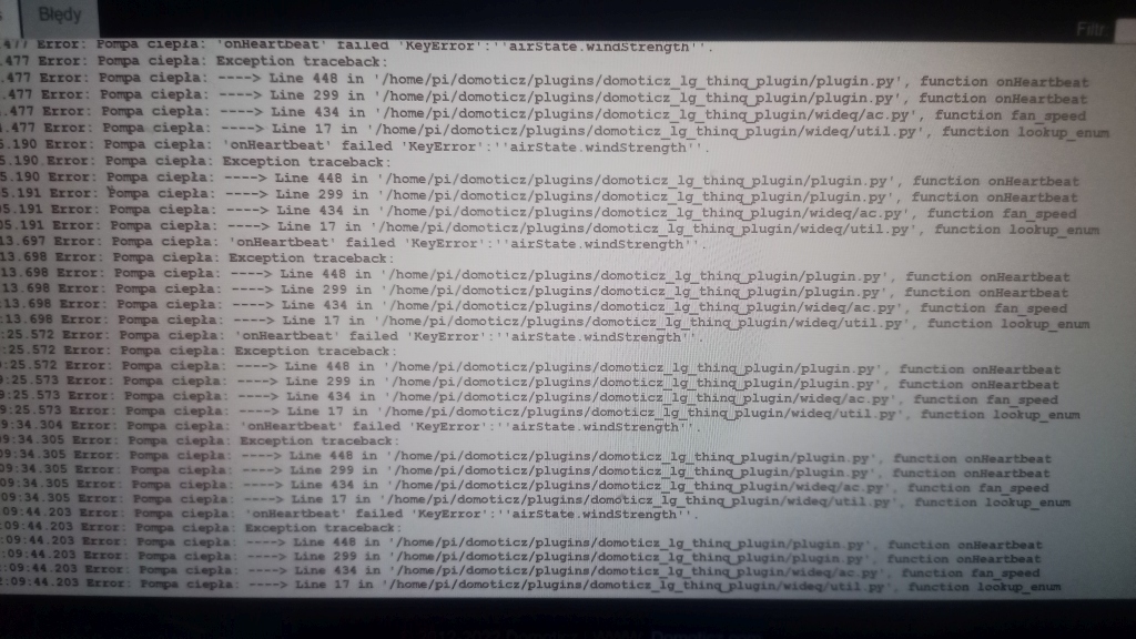

Hello @boosjgm.
I've checked your wideq_state.json file and I was able to read parameters. It shows that your heatpump's model operates with LG Thinq API version 1. Currently my addon doesn't support these devices, it supports API version 2 only - which is a little bit different. But, fortunately there's a domoticz plugin for v1 already (viewtopic.php?p=206548#p206548) - maybe it will work for your device.
Hello @majki
I try install your plugin, I get information after start example.py:
thinq2 devices: 1
c0386fd2-f2b4-1aae-892f-dc0398XXXXX: Pompa ciepła (AC AWHP_019101_WW / thinq2)
I moved file wideq_state.json to domoticz folder, restart domoticz and add hardware LG ThinQ on domoticz menu.
Domoticz add new devices, but these devices are not working (the devices are gray and do not show values) and get also errors in domoticz log (please see on attached picture).
I think that this plugin does not handle heat pumps properly :(
How to try to add heat pump support?
I can send wideq_state file content on PM.
