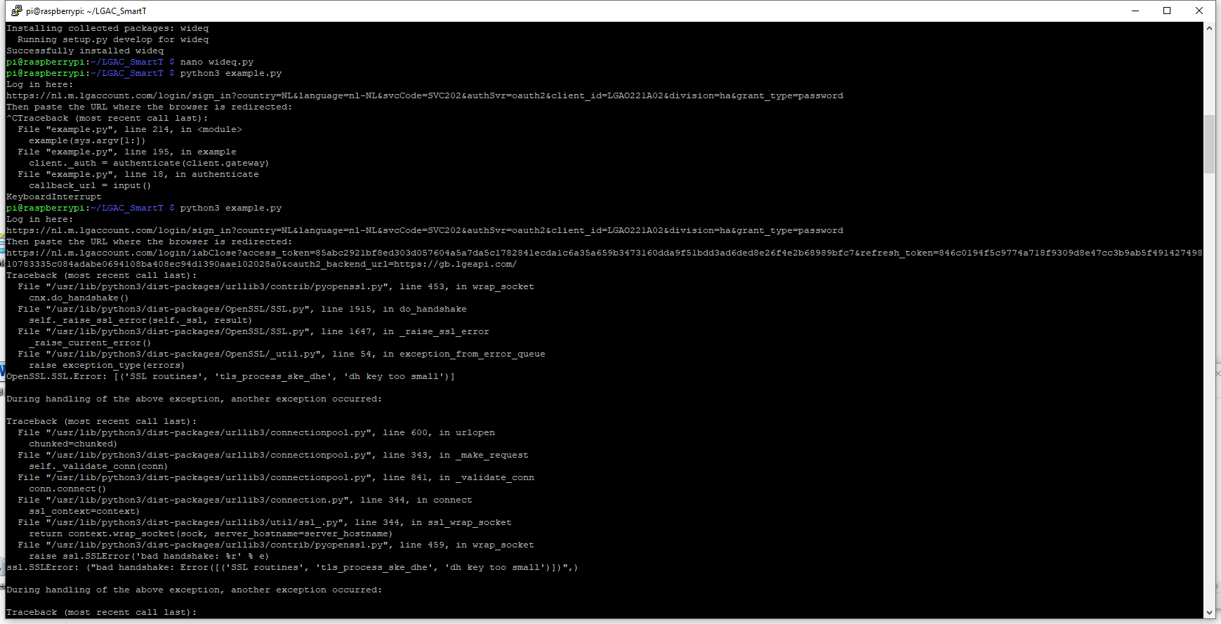

I tried to install this script, evrything was great til but i can't go further than an unsuccessfull test, i do not get the "wideq_state.json" file as supposed to have.
After having widep.py file updated i run the exemple.py script, and get this :
root@tynati:~/LGAC_SmartT# nano wideq.py
root@tynati:~/LGAC_SmartT# python3 example.py
Log in here:
https://fr.m.lgaccount.com/login/sign_i ... LGAO221A02
Then paste the URL where the browser is redirected:
https://fr.m.lgaccount.com/login/iabClo ... geapi.com/
File "example.py", line 214, in <module>
example(sys.argv[1:])
File "example.py", line 200, in example
example_command(client, args)
File "example.py", line 177, in example_command
ls(client)
File "example.py", line 25, in ls
for device in client.devices:
File "/root/LGAC_SmartT/wideq.py", line 474, in devices
self._devices = self.session.get_devices()
File "/root/LGAC_SmartT/wideq.py", line 465, in session
self._session, self._devices = self.auth.start_session()
File "/root/LGAC_SmartT/wideq.py", line 257, in start_session
return Session(self, session_id), as_list(session_info['item'])
KeyError: 'item'
root@tynati:~/LGAC_SmartT# ls
Controls.PNG Hardware.PNG LG-SThinq-AC __pycache__ setup.py wideq.egg-info
example.py LGACServerNew.py LICENSE README.md testServer.py wideq.py
What am i doing wrong ?

Finally I boughed a brand new Raspberry Pi 3B+
Installed newest Raspbian software
updated everything...
but now I get problems at the point where I logged in to LG and put the return URL in EXAMPLE.PY
see my screenshot with a lot of errors....
example pi error.png (99.92 KiB) Viewed 17554 times

Melissen
Posts: 65
Joined: Wednesday 16 November 2016 9:39
Re: Python Plugin: LG Smart AC (SmartThinQ)
Post by Melissen »
WOW !!! Problem solved..... I had Raspbian Buster installed, went back to Stretch and no problems with installation....
Didn't copied the folder to domoticz yet.
I've 2 airco's and want them both installed in Domoticz, how will I do that?
