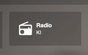

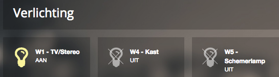

I've changed the collor of bulb_on in to a smooth yellow bulb
Is there a possibility to ad some more images (switch, tv, door-contact etc.)
- bulb_on.png (15.36 KiB) Viewed 3408 times

Yeah, it is quite easy:gjaa wrote:I've changed the collor of bulb_on in to a smooth yellow bulb
in main.js before:
else {
var switchHTML = '<div class="col-md-4 mb no-pr" data-light="'+data.result[r]['idx']+'" onclick="switchDevice(this);">';Code: Select all
else if (data.result[r]['Name']=='Radio'){
switchHTML+='<div class="transbg"> ';
switchHTML+='<div class="col-md-4 no-padding">';
if(data.result[r]['Status']=='Off') switchHTML+='<img src="img/radio_off.png" class="off icon" />';
else switchHTML+='<img src="img/radio_on.png" class="on icon" />';
switchHTML+='</div>';
switchHTML+='<div class="col-md-8 no-padding">';
switchHTML+='<strong class="title">'+data.result[r]['Name']+'</strong><br />';
if(data.result[r]['Status']=='Off') switchHTML+='<span class="state">KI</span>';
else switchHTML+='<span class="state">BE</span>';
$('#switches').append(switchHTML);
}To convert font-awesome icons to png I found this website: http://fa2png.io. Just change color to any what you prefer and size to 57px, leave margin on 0.
robgeerts
- Posts: 1273
- Joined: Saturday 24 January 2015 22:12
- Domoticz version: 3.7067
Re: New Dashboard Design
Thanks, I've added this to Gitlab for the radio-button, as set in CONFIG.JShpapagaj wrote:HansieNL:
buttons.radio = {image: 'img/radio_on.png', title: 'Radio', url: 'http://nederland.fm'}
Added this to Gitlab, you can now simply change the following line:gjaa wrote:I've changed the collor of bulb_on in to a smooth yellow bulb
var buttonimg = 'bulb';Code: Select all
var buttonimg = 'bulbyellow';-

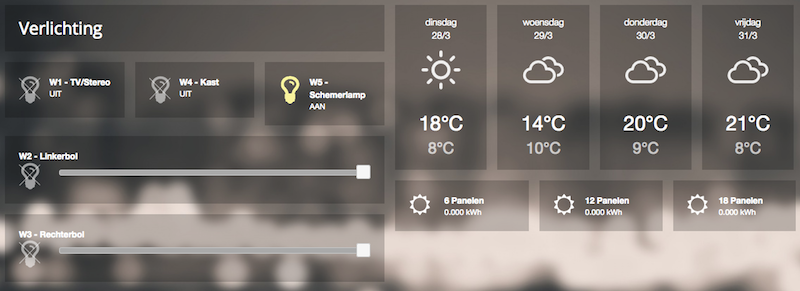

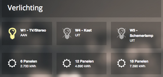

Another question
How can I add my solarpanels?
I entered ...../json.htm?type=devices and catched the devices (see atcached file)
else if(data.result[r]['HardwareType']=='PVOutput (Input)'){
$('.block'+data.result[r]['idx']).remove();
var switchHTML = '<div class="col-md-4 mb no-pr" data-light="'+data.result[r]['idx']+'">';
switchHTML+='<em class="fa fa-sun-o"></em>';
switchHTML+='<span class="state">'+data.result[r]['CounterToday']+'</span>';

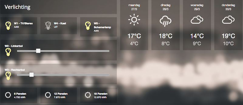

- gjaa
- Posts: 38
- Joined: Thursday 12 February 2015 6:59
Very nice, thanks But how can I place them under the weather forecastrobgeerts wrote:I added it to Gitlab, you can download the latest version (or only main.js) or add the following code to main.js:gjaa wrote:Thanks, it's working
Another question
else if(data.result[r]['HardwareType']=='PVOutput (Input)'){ $('.block'+data.result[r]['idx']).remove(); var switchHTML = '<div class="col-md-4 mb no-pr" data-light="'+data.result[r]['idx']+'">'; switchHTML+='<div class="transbg"> '; switchHTML+='<div class="col-md-4 no-padding">'; switchHTML+='<em class="fa fa-sun-o"></em>'; switchHTML+='</div>'; switchHTML+='<div class="col-md-8 no-padding">'; switchHTML+='<strong class="title">'+data.result[r]['Name']+'</strong><br />'; switchHTML+='<span class="state">'+data.result[r]['CounterToday']+'</span>'; switchHTML+='</div>'; switchHTML+='</div>'; switchHTML+='</div>'; $('#switches').append(switchHTML); }

Try changing #switches to .buttons (or #buttons), cannot check right now unfortunately...
- gjaa
- Posts: 38
When I change to #buttons or .buttons pv-output dissapears, but when I change it to #sliders it appears under the sliders, that's better than between the lightsrobgeerts wrote:Try changing #switches to .buttons (or #buttons), cannot check right now unfortunately...
robgeerts
- Posts: 1273
Ok, if you want there's a title option you can set wich appears beneath those sliders... Take a look at config.js

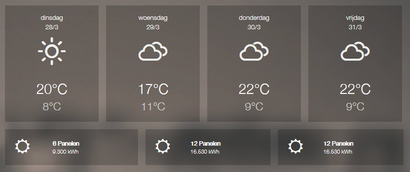

- gjaa
- Posts: 38
But is it possible to get the solarpanels under the weather forecast?robgeerts wrote:Ok, if you want there's a title option you can set wich appears beneath those sliders... Take a look at config.js
robgeerts
- Posts: 1273
Download the latest version from Gitlab, OR edit the code manually:
In index.html, BEFORE:
Add this:
And in main.js:
Change the elseif-statement you've added earlier into this:
AND ADD BEFORE:
Add this:
<div class="row containstraffic mb">Code: Select all
<div class="row containssolarpanels mb">
<div id="solarpanels"></div>
</div>
if($('.solar').length==0) var classn='no-padding';
