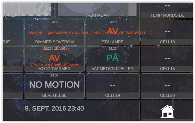

Anybody know what happened here? I have had a working frontpage, but now I was excluding and including some units and moving from Windows to Raspberry PI. It's a dimmer in cell 8 and a on/off module in cell 13
Screen Shot 09-09-16 at 11.41 PM.PNG (382.72 KiB) Viewed 4028 times
