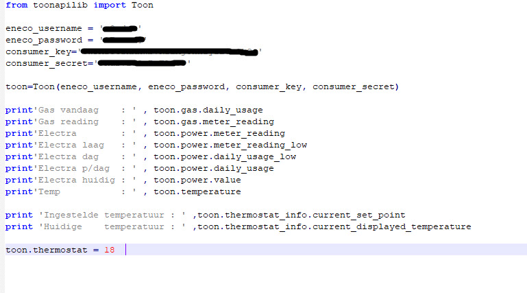

When you use the TOON app first, then you might be able to change the setpoint from domoticz.
At least, that is what I saw yesterday.
Probably the same goes for scenes/thermostat states.
If I use the example code from the toonapilib, I cannot change the scene. (home/comfort/away..)
The last toonapi lib version seems to be working with python 3.5 again. You can use pip to install the latest version.
So that's good news as we can have bugfixes etc from the toonapilib instead of working with 3.0.2 forever.
Maybe it's time to ask the toonapilib developer for help.

No Problems here with connection , but the setpoints indeed is a problem it is working irregular.
When i use the toonapi apart from domoticz in python it is working ok

While I was testing with a python test script, the setpoint temperature did not change everytime.a3vd wrote:No Problems here with connection , but the setpoints indeed is a problem it is working irregular.
Same goes for state/scene.
Will test it again. Also have support from the developer of toonapilib himself. He is willing to check some stuff in the next days.

Please update to toonapilib v.3.0.10!
This release fixes the set point and set state issue.
I will release a plugin version soon that support setting the states.
