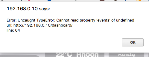

Still having problems with the combined and private calendar. Business is working.
Something I just thought of, In Textwrangler (some sort of programm to write code in), the 'private' part is in blue-ish colour, while .combined isn't.
columns[1] = {}
columns[1]['blocks'] =
['blocktitle_1','s1',91,51,99,125,52,53,54,55,56,'blocktitle_11',calendars.private]//idx 57 - 62 reserve KaKU
columns[1]['width'] = 5;
Error messagee
Error messagee

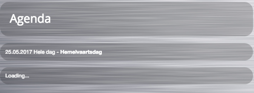

Business is still working
Private keeps loading but doesn't seem to finish.
combined gives an error

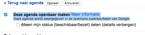

Any progress EdKo66 ? Your private calendar IS shared, right?
EdwinK
Posts: 1820
Location: Rhoon
Re: Dashticz - Module - Calendar
Post by EdwinK »
Yeah, it is. Didn't had any time to test it more this week though.
Screen Shot 2017-05-18 at 19.15.08.png (29.42 KiB) Viewed 2661 times
Calendar is :
Screen Shot 2017-05-18 at 19.16.42.png (79.87 KiB) Viewed 2661 times
