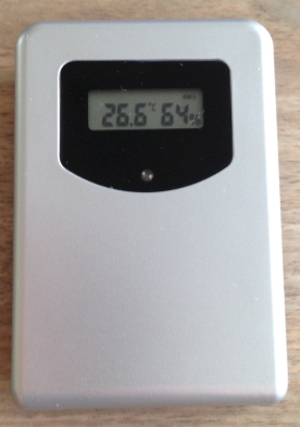

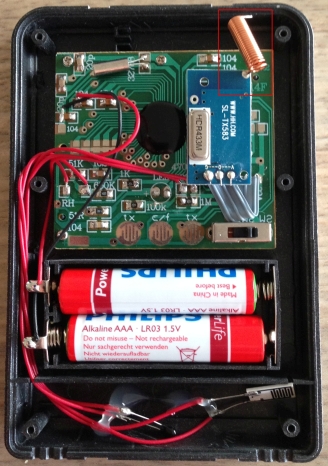

I have this one, it's fairly obvious where the antenna is at:ThinkPad wrote:Yes.
Just do it yourself, very easyvoorzien van flexibele draadantenne5 min work.

I also have that one
Should be really easy to mod them, just replace that coil by a 17cm wire.
Or stretch it and cut it at 17cm from the solderpoint.
But i don't have any issues regarding transmission range, so i'll leave it original.

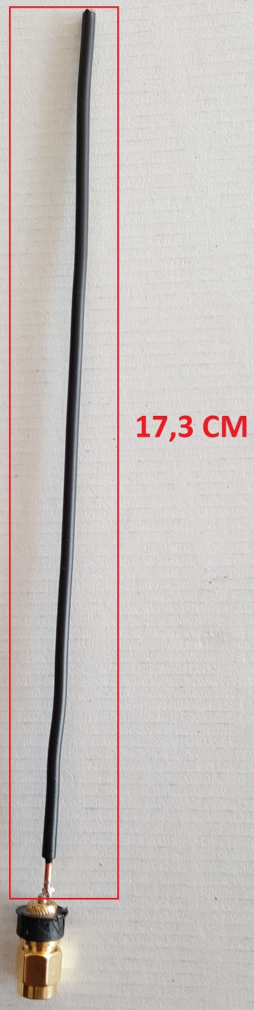

I bought this antenna: http://www.ebay.com/itm/281126334307 and pulled the plastic off.
Then desoldered the standard coil, and attached a 17cm stiff wire of a networkcable to it like this: Drilled a small hole in the top of the plastic tube so the wire can go through it, pressed the plastic tube back on to the connector and ta-da! Works fine and will cost you little.
Just ordered the antenna, let's see and find out

Received the replacement antenna and soldered 17,3 cm stiff (installatiedraad) to the base.
Doesn't make that much difference compared to the one I already had installed That can be ordered for a few euros for example here:
http://www.ebay.com/itm/Radio-433Mhz-5D ... 0945866818
Suggestions anyone?
Suggestions anyone?
