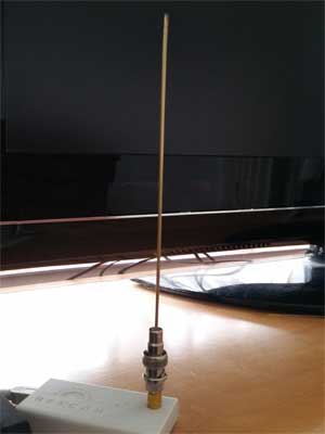

I replaced the original antenna with a piece of wire of 17 cm long and had an increase with at least 1 point in reception level. All sensors in my (big) garden can now be received and the switches do react.
There must be something wrong with the original antenna of the RFXtrx433E I am using, or with the end stage of the transceiver. The used wire is a single core copper wire which fits in the SMT-connector when I bent it double.

I made my own out of some brass rod, works better than the standard one.

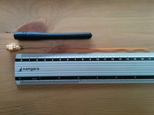

See https://www.brunier.nl/?p=622 for a example from someone else.
I bought this antenna: http://www.ebay.com/itm/281126334307 and pulled the plastic off.
Then desoldered the standard coil, and attached a 17cm stiff wire of a networkcable to it like this:
Drilled a small hole in the top of the plastic tube so the wire can go through it, pressed the plastic tube back on to the connector and ta-da! Works fine and will cost you little.
