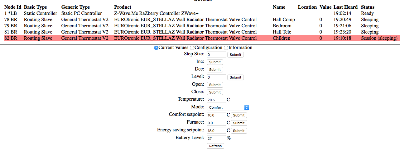

Re: StellaZ vs Danfoss Living connect vs Komforthaus Comet ?
STELLAZ - using the second year
local upTemp = 30
local downTemp = 10
if tempTempHum - tempTsV <= delta then
setTemp = upTemp
elseif tempTempHum - tempTsV >= 0 then
setTemp = downTemp
commandArray[#commandArray+1] = {['UpdateDevice'] = thermostatIdx..'|0|'..tostring(setTemp)} - Attachments
- Снимок экрана 2016-09-28 в 19.23.44.png (127.28 KiB) Viewed 5728 times
- Снимок экрана 2016-09-28 в 19.22.45.png (241.81 KiB) Viewed 5728 times
