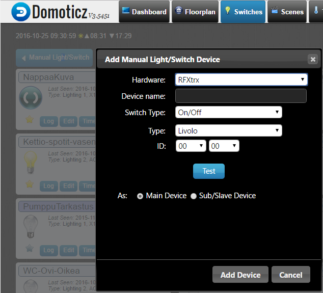

Post by pj-r »
rotoco wrote:I've put the Livolo switch into its pairing mode by holding a button until it beeps. However, it does not show up in Domoticz's Devices page.
It do not show up automatically since livolo switch cannot send anything. Its only receiver.
So go to switches tab and click "Manual light/switch" button. Then select RFLink as hw, Give name, Switch type: On/Off, Id: pick up something. No all id:s are working so you might have to test multiple ones.
Then put your livolo switch to pairing mode and hit the test button in domoticz. If test success then add the new switch with Add Device button.
