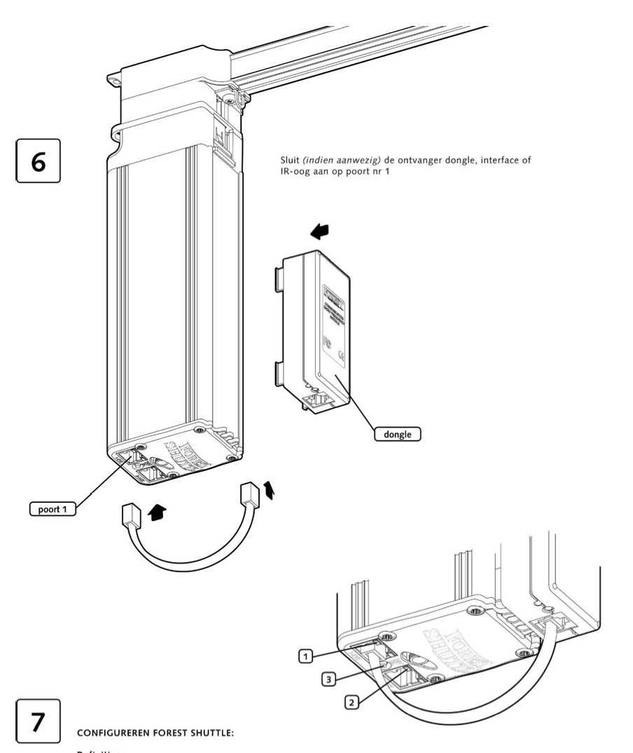

I have an electric curtain brand/type: Forest Shuttle with a Z-wave module attached to it. If operated manually (by pulling the curtain a little bit), it opens and closes as expected, thus the 'open' and 'closed' positions are known.
Today I started using Domoticz (Hi, new on this forum!) on my Raspberry Pi 2 type B and followed this guide to configure the RaZberry z-wave controller. http://www.vesternet.com/resources/appl ... 9F16JN96L_.
First I included a Danfoss LC13 to control the temperature in my room, which works fine, so I assume the RaZberry is properly configured.
Then I included the Forest Shuttle. Inclusion worked and it shows up in the hardware list (see screenshots), but I have no clue how to configure the switch. I tried many switch types, such as blinds, blinds percentage, dimmer, on/off, push on button, but none seem to work properly.
The curtains sometimes randomly open or close, without pushing the switch buttons. Also the reaction time seems very slow; sometimes something happens almost a minute after switching things; how can I speed this up?
First, I'd like to have a button to fully open/close the curtains and avoid the random opening/closing. Can someone help me with that? Thanks in advance.
Once that's working I'd like to proceed maybe 'inbetween' scenes, where the curtains are not fully closed, but just a little.

- The highlighted one
- 2.-Node-is-included.jpg (300.78 KiB) Viewed 2276 times
- The motor and z-wave module
- Screen Shot 2016-09-08 at 16.24.42.png (226.06 KiB) Viewed 2276 times

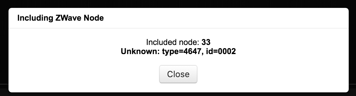

- inclusion successful
- 1. Include node.png (42.88 KiB) Viewed 2276 times

According to your last screenshot, de device itself is unknown, so there's no config xml - hence you can't configure your device. Are you on the beta channel or the stable one? The beta ozw contains one xml for this manufacturer, but it could be a new one which is not in the ozw github at all.

Thanks Louis. I'm sorry for not answering earlier, didn't have time to try again until now.
I was on the stable channel, but updated now to beta Version: 3.5700. I excluded the node and included it again. I get the same message; unknown. I suppose it's a different one than the xml that is already on the beta ozw and thus not supported yet?
Is it possible to make such an xml myself? How do I make this work...
I also contacted the manufacturer. I've been told that they didn't make the Z-wave receiver themselves and thus don't have tech. specs, but that it's based on the receiver in the attached document. I hope this helps?

Kevink,
Use this link as guidance for a How-to
http://www.domoticz.com/forum/viewtopic ... anufact%2A
In domoticz/Config/electronicsolutions/
there is a file: dbmz.xml
You could try to use that one, it seems to be generic.
How-to:
In domoticz/Config/
there is a file: manufacturer_specific.xml
Search for electronicsolutions and Add:
Stop Z-Wave
Remove the node 033 related section from your zwcfg_0xaaaaaaa.xml
Restart Z-Wave
Check you log file and see if a Configuration screen comes for the node.
Hope this helps
Domosapiens
How-to:
In domoticz/Config/
<Product type="4647" id="0002" name="DBMZ Motor Control" config="electronicsolutions/dbmz.xml"/>Remove the node 033 related section from your zwcfg_0xaaaaaaa.xml
Restart Z-Wave
Hope this helps
Domosapiens

@Domosapiens
thank you for the detailed explanation. I'm new to Domoticz, so not really sure about the things I'm doing.
I didn't really understand the link you sent, but I managed to find the dbmz.xml file. I also added that product line to manufacturer_specific.xml.
I don't know how to stop and restart z-wave. I think I succesfully removed the 033 related section. Enclosed the file in case you want to check. Then I rebooted the raspberry pi. I hope this has the same effect as restarting z-wave.
Then I tried to include the node, and this time it showed:
"Included node:3
DBMZ Motor Control"
which, I think, is the desired result
Now under hardware, I think it's idx 3? I pressed the green button to "add light/switch device"
In the Switches tab, my new switch appeared. I expected my curtains to close after pressing it, but that didn't happen. I included what appeared in my log.
What does this timeout notification mean?

Re: Electric curtains behaving weird - Forest Shuttle
Update: It actually started moving after switching a few more times! But the response is slow, my log is still filled with:
OpenZWave: Received timeout notification from HomeID: 4029292394, NodeID: 3 (0x03)
And the behaviour is kind of unpredictable; currently the curtains just randomly open or close or open, then close again a few minutes after switching.
FYI: the raspberry pi with RaZberry module and curtains are in the same room - about 5m distance. Right next to the curtains is a Danfoss Z-wave thermostat, so I don't think the range is an issue.
Any ideas on how to improve?

- Domosapiens
- Posts: 232
- Joined: Wednesday 20 August 2014 12:08
- Target OS: Windows
- Domoticz version: V3.5981
The unit could be in the calibration state ....
Go to the Nodes configuration tab
Make a snapshotJust curious..
And are you able to configure:
- Unit calibration state
- Unit motor direction state
- Unit tilt feature state
In the Nodes configuration tab?
