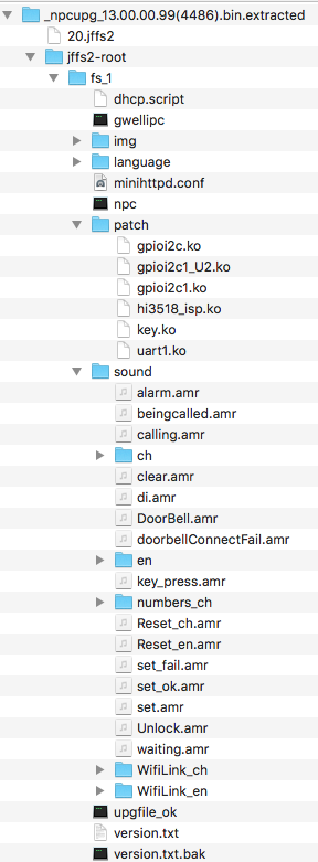

After some diggin I found a way to access the doorbell via UART. So I have full access to the running os (HiLinux 3.0.8).
I can modify files, start the telnetd, and so on. Due the use of certificates, I guess "hacking" the crypted IP traffic is pretty useless - too much work, by far
Installing my own linux is also a lot a work - but can be done du the open bootloader (u-boot). Unfortunately I might not be experienced enough to build it
BUT: I guess with a little programm installed on the sd-card (needs to be crosscompiled for that system, off course) I can poll the logoutput when e.g. the doorbell button was pressed.
This looks like this:
Then a message could be sent to any device in the network (e.g. domo server), starting a bell, open video,...

I do not have the doorbell with me - it's installed far away. But I have access to it via remote tools.jgonzalez wrote:Can you give us more information about how to connect to the UART in the doorbell board (the board pinout)?
So if you just send me the a picture of the lower side of the pcb (the side that looks to the main doorbell button) I will tell you.
riogrande75
- Posts: 21
- Joined: Thursday 27 October 2016 7:38
Re: IP Video Door Bell - Atz-dbv01p
Wit the help of this site http://nemon.org/ipcam-ipr1631x/ I was able to successful crosscompile and execute hello.c on our little doorbell.
Next step: write a programm in c, that recognizes the doorbell button press and send a message via ip/http.
Any programmers arround that could assist?
