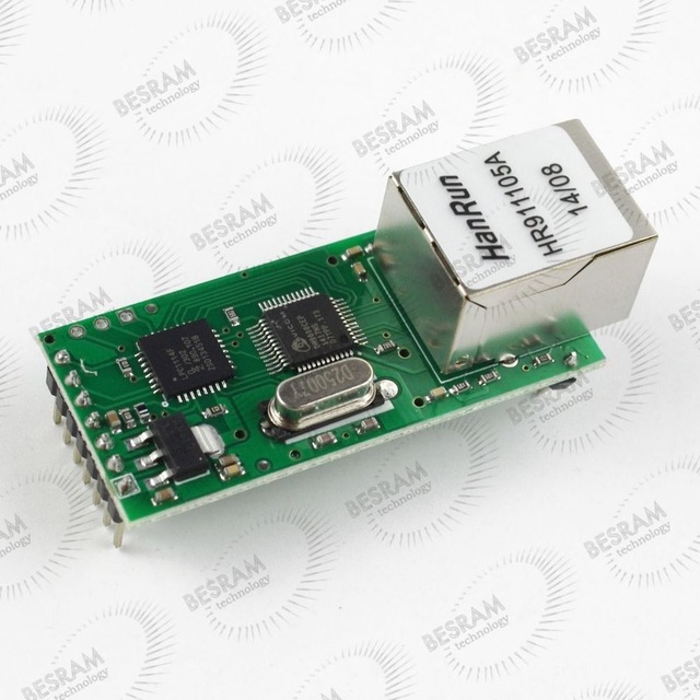

Something like this ?
http://nl.aliexpress.com/item/1pc-USR-T ... .52.oALqOd

@Domosapiens
That will only work in conjunction with a MAX232A. RS232 levels can be as high as 15V so a TTL device won't like it very much ;)
