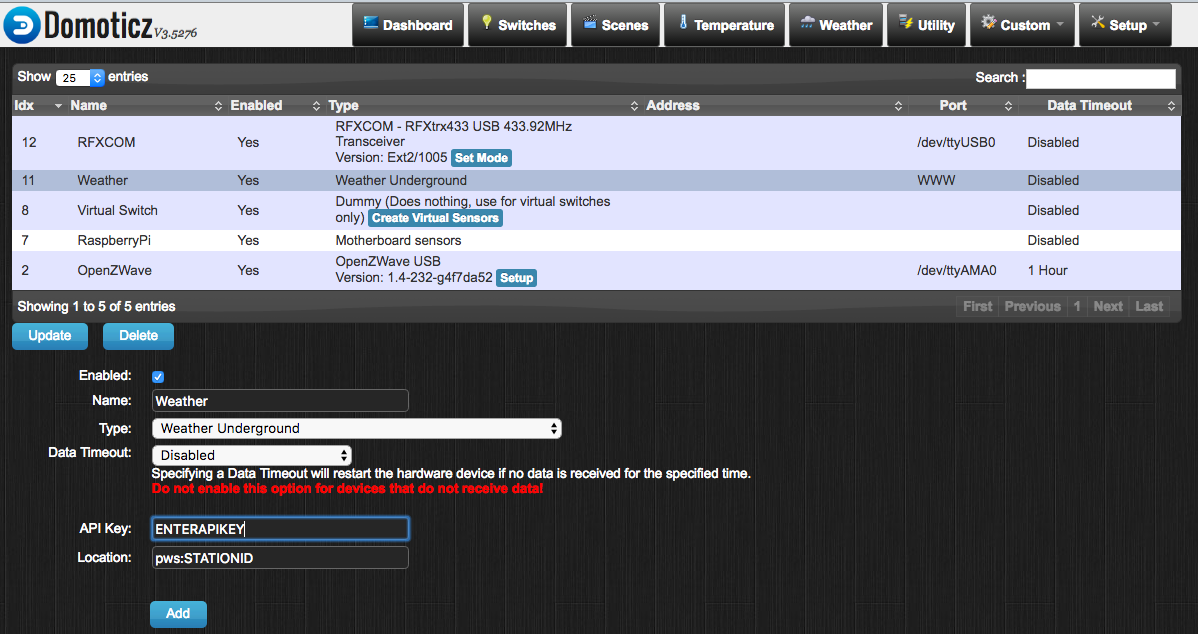

Yes you can just pull data from someone elses station which if there is someone nearby like you say basically achieves exactly the same thing as buying your own station, only it's free and you don't need to maintain it. :)

The pws: in location should be put there if your connecting to someone elses personal weather station, you just search and get the codes off the weather underground site. Also signup for the weather underground free API key, takes about 5 minutes to setup. :D

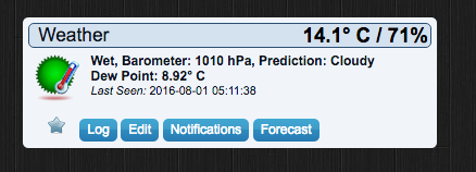

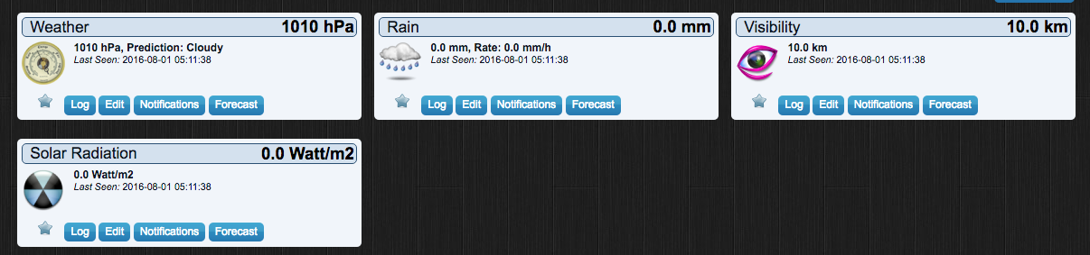

awesome, so i was able to get it added via the local station with an API code but the 'devices' are rather odd to me. much like what you show it seems to combine some things. in my case the the wind speed also has the temp, but the primary for it seems to be the wind speed. In your case i see you have a widget that has the pressure, temp and humidity. how did you make that with all the sub devices?
