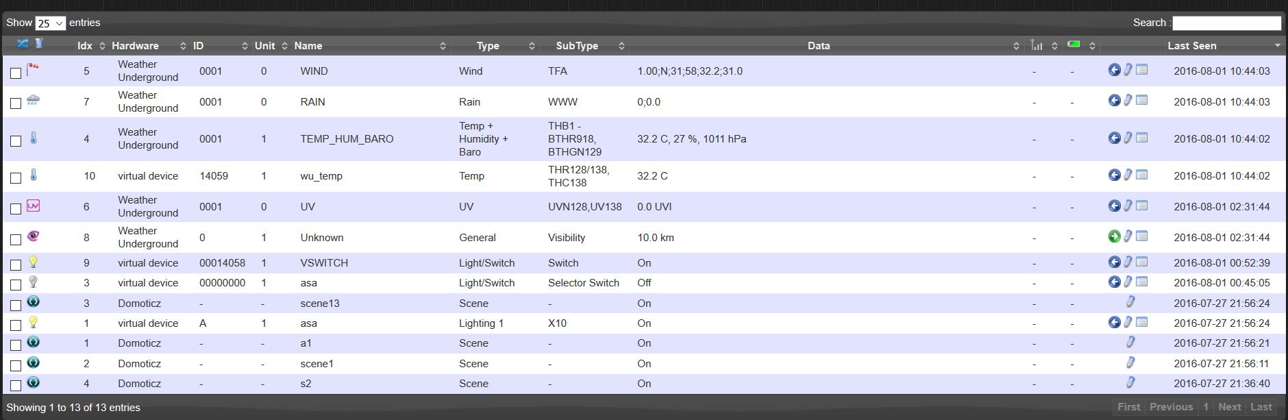

Can anyone help me why the following is not working...The email part is working ok.. but the temperature is not..I am using a virtual sensor which is getting the temp from WU.. i am also using the script to split the values in WU data. wu_temp is my virtual temperature sensor which works fine.

 2016-08-01 10:43:52.259 EventSystem: reset all device statuses...
2016-08-01 10:43:52.260 EventSystem: Started
2016-08-01 10:44:02.859 LUA: WU Script Parsed Temp=32.2 Humidity=27 Pressure=1011
2016-08-01 10:44:02.955 EventSystem: Script event triggered: C:\Program Files (x86)\Domoticz\scripts\lua\script_device_sensorWU.lua
2016-08-01 10:44:02.958 Error: EventSystem: in script5: [string "commandArray = {}..."]:2: attempt to concatenate field 'wu_temp' (a nil value)
2016-08-01 10:44:02.726 (Weather Underground) Temp + Humidity + Baro (TEMP_HUM_BARO)
2016-08-01 10:44:03.200 Error: EventSystem: in script5: [string "commandArray = {}..."]:2: attempt to concatenate field 'wu_temp' (a nil value)
2016-08-01 10:44:03.044 (Weather Underground) Wind (WIND)
2016-08-01 10:44:03.370 Error: EventSystem: in script5: [string "commandArray = {}..."]:2: attempt to concatenate field 'wu_temp' (a nil value)
2016-08-01 10:44:03.277 (Weather Underground) Rain (RAIN)
2016-08-01 10:45:14.068 EventSystem: reset all events...
temp domoticz.JPG (150.85 KiB) Viewed 7034 times
trixwood
