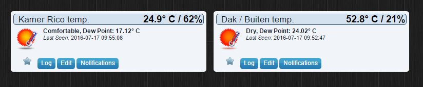

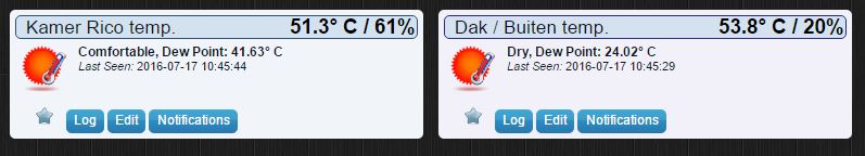

I currently run Domoticz on a Raspberry Pi with a RFXCom. The system runs really well and everything works as expected except my temperature sensors.
I have two temperature sensors from Ventus (WS155). One is on the roof of my house, combined with wind direction and speed, and one is in my computer room. The one in my computer room has a display on it. When it says 50C on Domoticz it does show the proper temp on the display of the sensor.
Every once in a while the temperature just jumps from around 24C to 50+C. It is always between that range. I must say if my computer room were to reach 50C i think i will need to move or something. haha
Is this a configuration error or are my sensors both just buggy?
By the way both sensors display the same behavior.
I hope someone has some ideas.

- Temp readings. Now both at 50C
- Capture.JPG (30.76 KiB) Viewed 1369 times
- Temp readings. One 50 plus the other 24 plus.
- temp1.JPG (34.11 KiB) Viewed 1380 times
