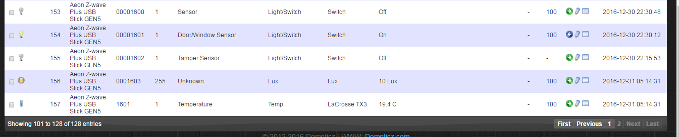

So I have a Philio 4in1 doorsensor (PST02-A). Hooked it up without any problems, but there are more devices than I anticipated and they're not clearly named. Please also have look at the below screenshot. These are the supported functions: PIR, Door/window, temperature and illumination.
I have not renamed any of the devices, apart from the doorswitch where I've only added "voordeur" to the name. Obviously the lux and temperature sensor can also be clearly seen. So 334, 303 and 301 are accounted for. Leaves 333, 332, 300 and 335.
I'm guessing on their workings that the 335 is the PIR and 300 is the tamperswitch, but I'm not sure.
I've read things that a time-out needs to be added to the motion sensor to turn it back off, but I don't know how to do that. Would anyone be able to help me identify these subdevices?

I've got two of these sensors. One functions fine; movement is detected correctly and the sensor state goes off after a while.
The other one stays on constantly.
How did you fix this?

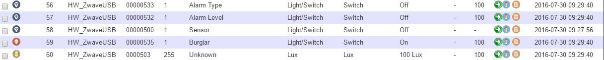

Hello all,
I also just bought 2 3in1 sensors (PST02-B) with temp / lux / motion / temper.
Somehow I also don't get the motion sensor to go to OFF state.
I tried to change the BURGLAR to type Motion and updated the PIR Redetect Interval to 1 tick (8 seconds), but somehow it remains in ON state.
It does seem to send an ON signal when motion is detected, but last night also every 30 minutes approximately we received an ON signal, interfering with normal motion detection.
Does anyone have a suggestion?
Help is much appreciated.
pascal252
Joined: Saturday 30 July 2016 9:18
Re: Philio 4in1 - No idea what most of the subdevices are
Post by pascal252 »
I think I found it by using the Domticz setting for timeout.
Seems to reset to OFF after 10 seconds now.
