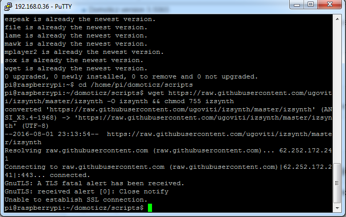

I'm falling over on the very first post of this. following the instructions and just getting this! Please help.
EDIT: I'm still not able to get past this point :(
Is there a way I can install this manually?
EDIT EDIT: It appears that my ISP (VM) was blocking the SSL connection. A google search showed this to have happened to others too. I have now moved providers (not just because of this issue) tried again and izSynth installed easily.
jin
Posts: 62
Joined: Thursday 18 September 2014 20:28
Re: izSynth: make domoticz talk with many TTS engines in a easy way
Post by jin »
With wget, try eg. --secure-protocol=tlsv1 or --secure-protocol=sslv3
try searching google:
https://www.google.it/?gws_rd=ssl#safe= ... connection
markk
Posts: 267
Post by markk »
jin wrote:Hi,
Thanks for your reply. On Monday evening I was following the suggestions in the link you provided when my internet connection bombed out (I hope that was only coincidence!) so couldn't carry on trying. Now waiting for a Virgin Media engineer visit tomorrow!!
Seriously though, could the internet have gone down because of something I did whilst doing wget --secure-protocol=tlsv1 and --secure-protocol=sslv3??
