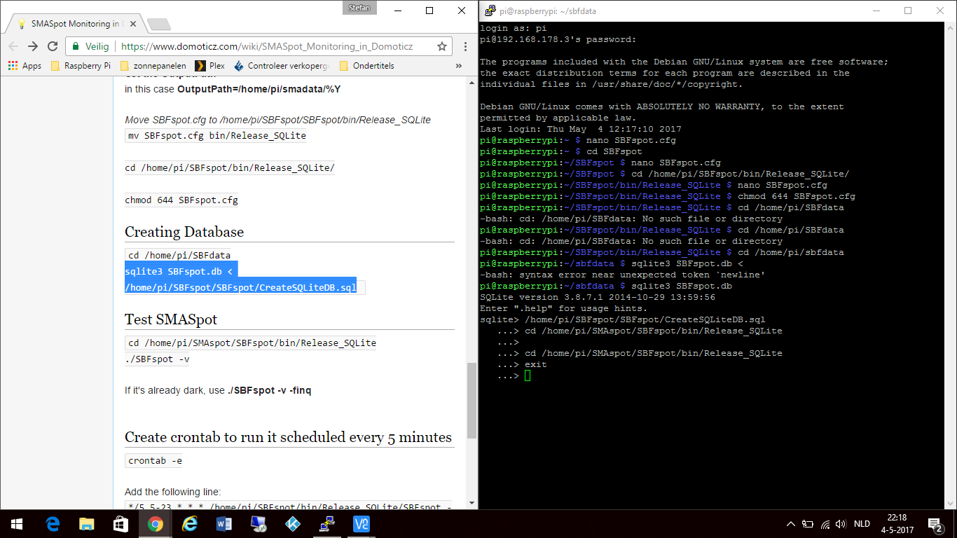

I see what I was doing wrong. By installing SBFspot manualy I placed it directly in the SBFspot file.
SO, In my case this line:
sqlite3 SBFspot.db < /home/pi/SBFspot/SBFspot/CreateSQLiteDB.sql
Must be:
sqlite3 SBFspot.db < /home/pi/SBFspot/CreateSQLiteDB.sql
This solved my problem
Yes that's where I got stuck but I downloaded it manually and resumed with:
tar -xvf SBFspot_SRC_331_Linux_Win32.tar.gz
I replaced 312 with 331 because that is the newest release I thouhgt.
After that I resumed the Wiki with:
And now I got stuck again, see attachment.
