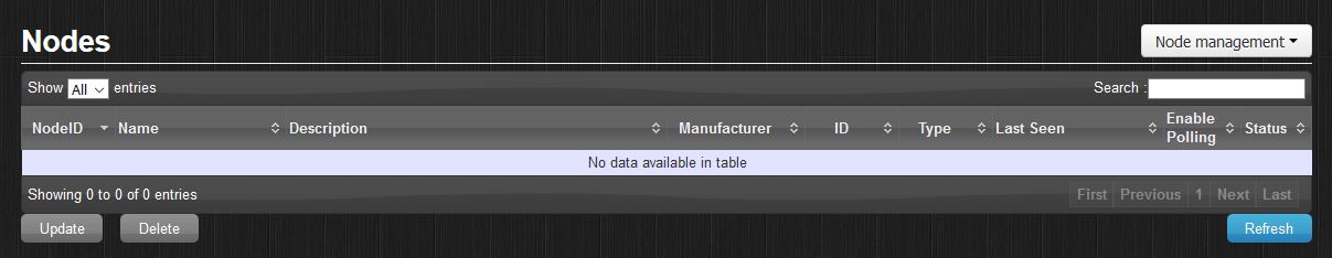

I guess something is broken now?? As Zwave is devices are not working anymore and the ZWAVE configuration is totally empty.

sincze wrote:I guess something is broken now?? As Zwave is devices are not working anymore and the ZWAVE configuration is totally empty.
 2017-04-13 17:42:31.591 OpenZWave: Starting...
2017-04-13 17:42:31.591 OpenZWave: Version: 1.4-2499-g636ec52-dirty
2017-04-13 17:42:31.592 OpenZWave: using config in: /home/linaro/domoticz/Config/
2017-04-13 17:42:32.605 OpenZWave: Received timeout notification from HomeID: 0, NodeID: 255 (0xff)
2017-04-13 17:42:33.607 OpenZWave: Received timeout notification from HomeID: 0, NodeID: 255 (0xff)
2017-04-13 17:42:34.610 OpenZWave: Received timeout notification from HomeID: 0, NodeID: 255 (0xff)
2017-04-13 17:42:35.612 OpenZWave: Received timeout notification from HomeID: 0, NodeID: 255 (0xff)
2017-04-13 17:42:35.589 (RFXCom) Temp + Humidity (TH7_Woonkamer)
2017-04-13 17:42:36.615 OpenZWave: Received timeout notification from HomeID: 0, NodeID: 255 (0xff)
If I unplug and replug the stick my dmesg shows:
[94521.140936] usb 5-1: USB disconnect, device number 2
[94540.446004] ehci_irq: port change detect
[94540.575920] ehci_irq: port change detect
[94540.925375] usb 5-1: new full-speed USB device number 3 using sw-ohci
[94541.121095] cdc_acm 5-1:1.0: This device cannot do calls on its own. It is not a modem.
[94541.130311] cdc_acm 5-1:1.0: ttyACM1: USB ACM device
So I need to update the port in the hardware settings
Pass2php
USB: RFXCom, ZWave, Sonoff 3
MQTT: ZIgbee2MQTT,
ZWAVE: Zwave-JS-UI
Solar: Omnik, PVOutput
Sensors: You name it I got 1.
sincze
Posts: 1302
Domoticz version: 2024.4
Re: USB handling (Raspberry Pi + Aeon Labs Z-stick + Domoticz)
Post by sincze »
The LED on the ZWAVE stick were not flashing anymore.
I unplugged the device.
Waited 30seconds.
Replugged the device.
The device was now recognized as ttyACM1.
Modified the settings in Domoticz. And now the network is back online
