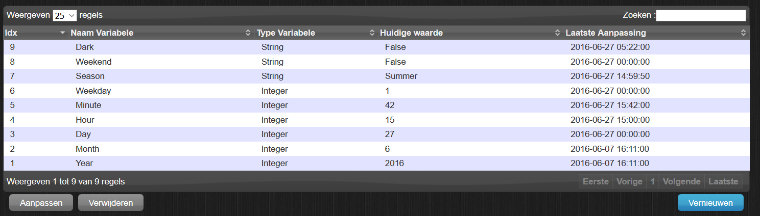

Blockley has its limitations. I have therefore started to work with LUA.
Domoticz generates the needed user variables (copy/paste from WIKI user variables).
Knipsel 2.PNG (71.57 KiB) Viewed 852 times

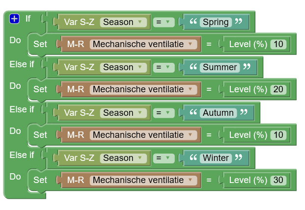

Next blockley is not working.
Knipsel 1.PNG (47.13 KiB) Viewed 849 times
The selector only responds if the variable season is adjusted via the web interface. (as described on the forum. LUA in combination with Blockley causes problems). Therefore, a first attempt with a LUA script.

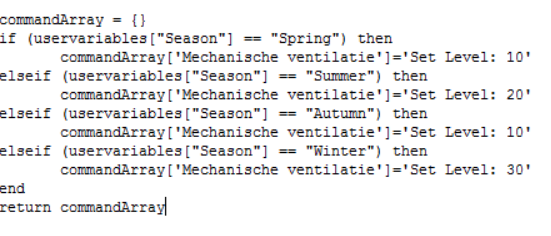

I'm looking for help because my first LUA script does not work. Who can point me in the right direction.

Jan,
The Set level command is wrong and should read: 'Set Level 10'.
One other thing to remember is that each time a Variable is changed via the Web interface or JSON, this script will run and set the ventilatie to the set level.
Jos

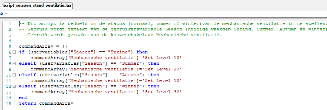

I changed the script.
Knipsel 4.PNG (95.91 KiB) Viewed 821 times

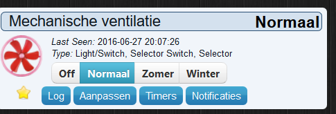

Then I clicked on the line Season (user variables) and at last I clicked the button adjust. I expected that the selector switches from "Normaal" to "Zomer" but nothing happens, even in the log.
Using blockley the selector switches as expected.
Jan

Have you made the LUA script with the internal Editor or is it a File in the Lua directory?
In the latter case the name of the file is important and should be: script_variable_xxxxxx.lua.
Jos

Post by Jan Jansen »
Hello Jos,
Thanks a lot.
The name of the file was the clue. Now every thing works as desired.
