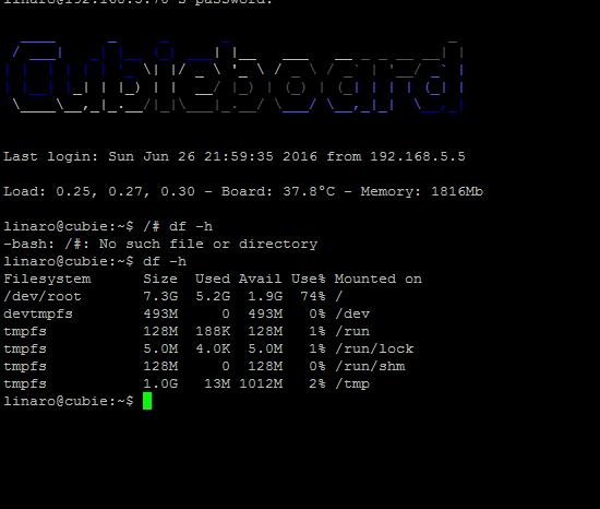

mmm you think i am smart .....
Only this screendumps are almost my max ,,

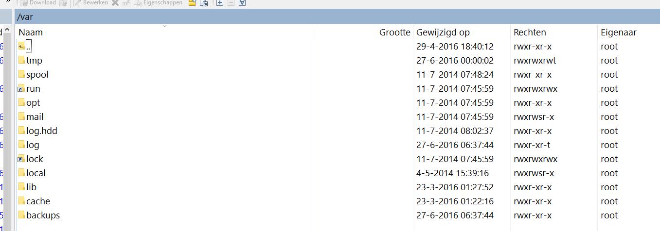

- jvdz
- Posts: 2441
- Domoticz version: 4.107
Re: HDD is running to the max
Not when you still want to use the system afterwards.Derik wrote:Can i just simple delete the whole map ./var
So have you checked the subdirectories for large files. I would first check /log, /backups and /tmp
Jos

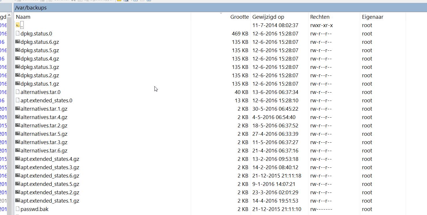

Just the first big ones?
And here to?
Can i remove the older versions???
The only backup i wil give a lot of money is my Domoticz DB...
When my OS stock, i set a new os on my sd...

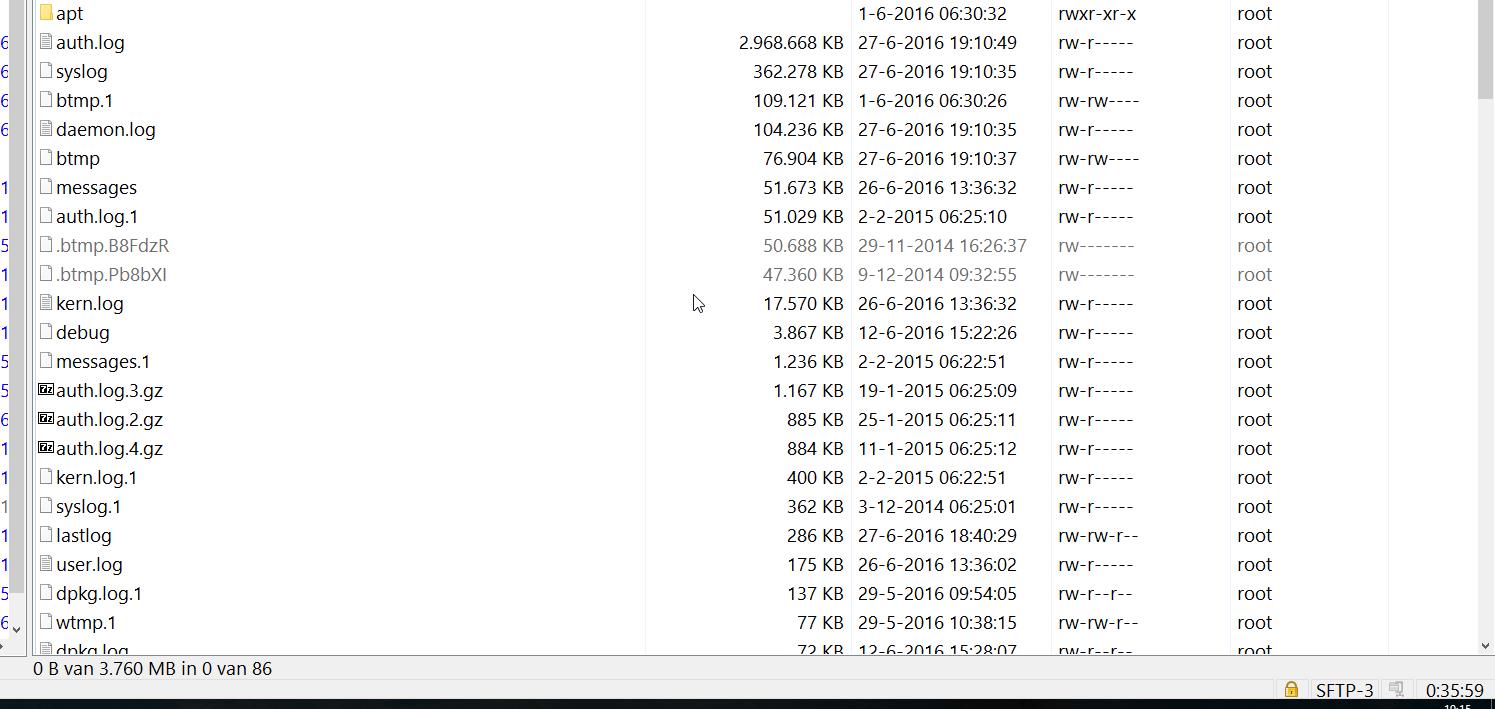

- jvdz
- Posts: 2441
Seems you aren't running the logrotate utility that normally would clean and compress logfiles to ensure they don't grow to that size.
EDIT: Looks like it was working till 25 January last year as there are compressed versions of auth.log
Jos

- jvdz
- Posts: 2441
Why worry about the few Kb's of the DPKG? The issue seems to be the log files not being cleared.
You can find quite some hits on Google on this question around deleting auth.log, but think you really should fix the logrotate so the system won't fill up again over time.
Jos
Jos

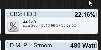

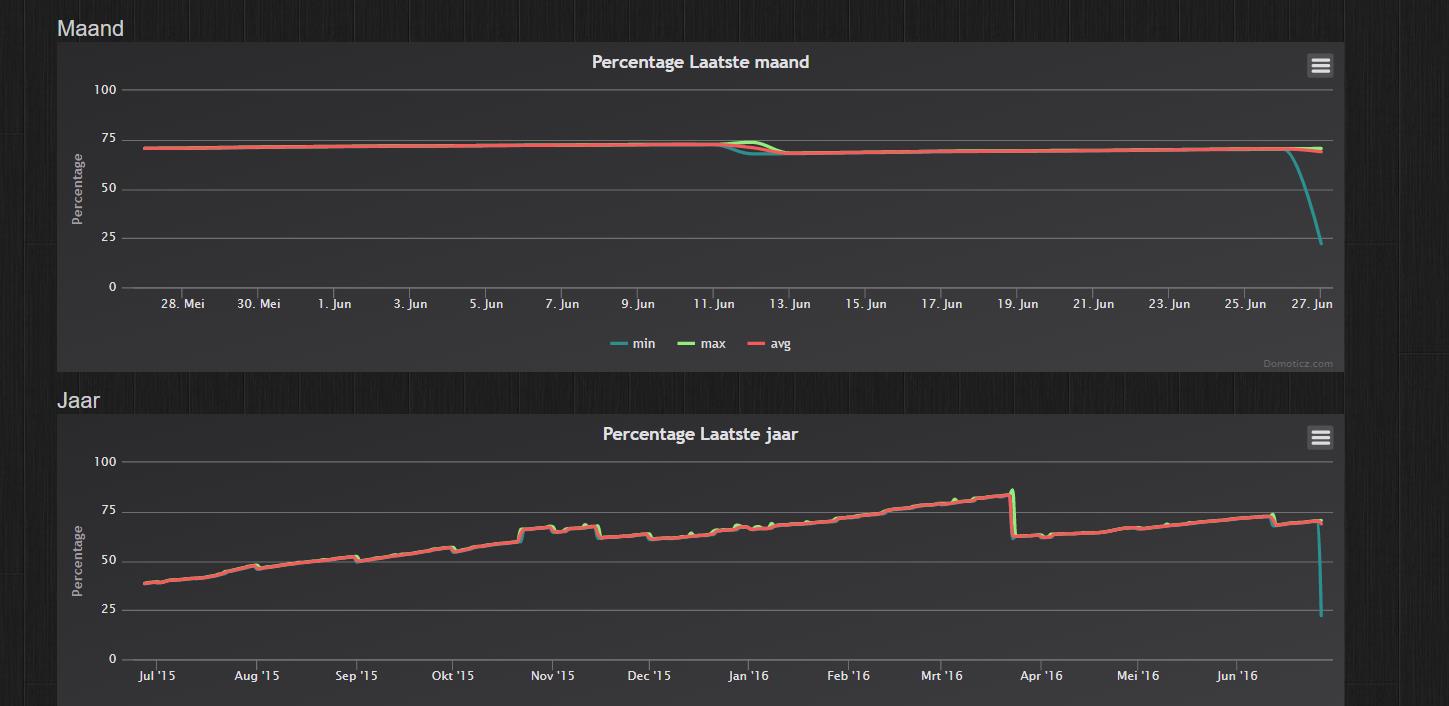

Hero's....
And proud @ myself...
- Egregius
- Posts: 2592
- Domoticz version: v2024.7
- Location: Beitem, BE
I would run these commands:
sudo truncate -s 0 *.log -> empty all logfiles without deleting them and thus preserving ownership and permissions.
sudo rm *.gz -> remove all old compressed logfiles. This can also be done in /var/backups
Don't know what those btmp files are occupying 200MB, should google that to see if it's safe to remove/empty them.
Also, try to find out why logrotate doesn't run anymore, then that handles it automatically for you.
In the config files of logrotate you can specify how many .gz files are kept.
Derik
- Posts: 1605
- Domoticz version: BETA
linaro@cubie:~$ cd /var/log
linaro@cubie:/var/log$ sudo truncate -s0 auth.log
linaro@cubie:/var/log$ sudo truncate -s0 syslog
linaro@cubie:/var/log$ sudo truncate -s0 daemon.log
linaro@cubie:/var/log$ sudo truncate -s0 kern.log
linaro@cubie:/var/log$ sudo truncate -s0 btmp.1
linaro@cubie:/var/log$ sudo truncate -s0 message
linaro@cubie:/var/log$ sudo truncate -s0 messages
linaro@cubie:/var/log$ sudo truncate -s0 auth.log.1
linaro@cubie:/var/log$ sudo truncate -s0 debug
linaro@cubie:/var/log$ sudo truncate -s0 messages.1
linaro@cubie:/var/log$ sudo truncate -s0 kern.log.1
linaro@cubie:/var/log$ sudo truncate -s0 syslog.1
linaro@cubie:/var/log$ sudo truncate -s0 lastlog
linaro@cubie:/var/log$ sudo truncate -s0 dpkg.log.1
THANKS ALL!!
