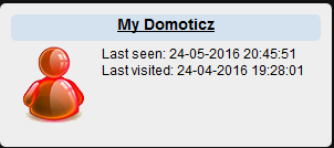

Post by Minglarn »
Add me to this too...
From the log...
2016-05-24 20:45:51.290 PROXY: Authenticate result: success.
2016-05-24 21:02:11.340 Error: PROXY: Read failed, code = 335544539. Reconnecting: short read
2016-05-24 21:02:46.362 Error: PROXY: StartThread(): Exception: resolve: Host not found (authoritative)
Clearing the api key and saving fixes this for another 15 min... But its seems that 15min is the limit.

Minglarn wrote:Add me to this too...
From the log...
Thanks for these log lines. Seems a name server issue. Either within the domoticz code or external.
