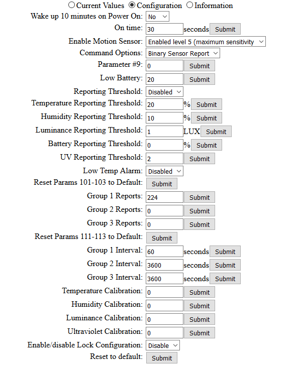

@sweup, what are you attempting to do with Parameter #9? I've got 4 of these and on 2 of them there is no parameter #9 and on the others it is undocumented. From screenshots posted here it looks like it is undocumented for others as well.
@JuanUil, I had more luck setting the configuration for mine via the OZW Control Panel (from the Node Management drop down in the Setup page)
I've had good success with the set up below with powered sensors. Threshold reporting didn't work for me, I got reports every second but these settings will report PIR movement (PIR stays on for 30 seconds each movement) and Temp, Humidity and Lux every minute to the controller.
