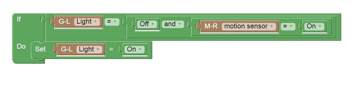

I've started to experiment with MySensors and blockly. I only have one sensor and 1 actuator, both are childs of the same node.
I want to turn on the light only if the light was off and if there is motion. If the light is already on then there is no need to send another radio transmission.
The following example does not work.
I have tried a few other things that did work.
If motion sensor = on, Do Set light = on
If light = off, Do Set light = on
Both work. What am I doing wrong?
Extra info, I use Mysensors 1.5 and Domoticz Version: 3.4834

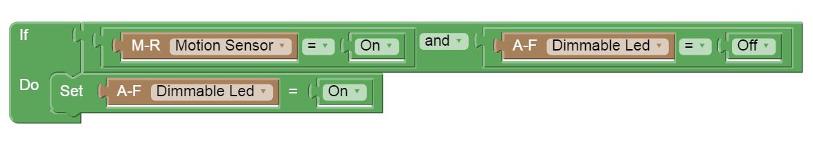

Look at your Blockly.....
You have to use the right logic blocks in the right place...

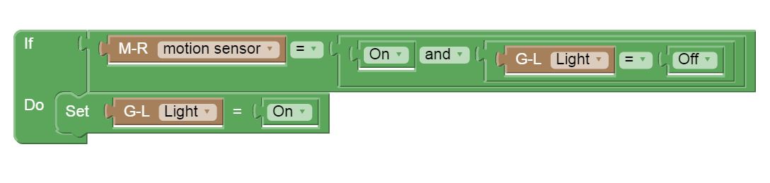

I swapped them. Is this okay?
Not so different to me.

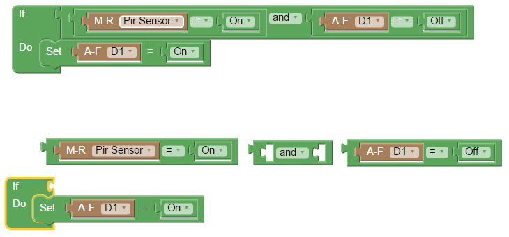

This must be working, Where D1 is a bulb. 2nd part you can see how it's build.

Guy I finally saw the difference :)
I start with the 'and' and then the inputs.
Thank you all.
@Treve I missed your comment, but that would have helped me.

Joerideman wrote:Guy I finally saw the difference :)
I tought "2nd part you can see how it's build." say's enough. you're fault was verry simple.
But it's working know, that's the goal.

I meant that I read your reply (message and image) after I figured it out.
