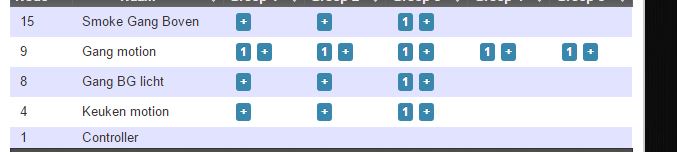

I solved my problems by associate groups 1 to 5 of the sensor (gang motion) to node 1, the controller. The old version of the sensor sends all report by default to node 1 and the new version doesn't. I also got a specific xml file for the ZW5 version from FHEM forum which you have to add to the /home/pi/domoticz/Config/fibaro folder and refer to in the added line in the manufacturer_specific.xml file. Remove the sensor from the controler and after adding the xml file and the reference in the manufacturer_specific file add the sensor back to the z-wave network. I had to restart domoticz to have the changes to work.
- Knipsel.JPG (43.67 KiB) Viewed 5662 times
- groups.JPG (24.77 KiB) Viewed 5662 times
- fgms-zw5.xml
- (18.49 KiB) Downloaded 232 times

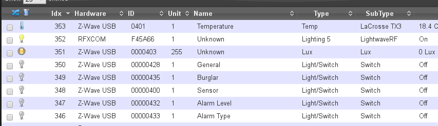

Right, so I've got what I believe is an FGMS002, which looks exactly like my first sensor. However when I tried to install it I got the message about it not being known.
I added the line to ~pi/domoticz/Config/manufacturer_specific.xml
<Product type="0801" id="1001" name="FGMS002 Motion Sensor" config="fibaro/fgms.xml" />
I then deleted the unknown device, waited overnight and then re-added. That worked and recognised the device. I then waited until last night and sure enough the parameter page appeared and a number of new devices were created. However, I don't know what half of the devices are. Is there a reference I haven't found yet, or can someone here help me.
0401 is obviously the temperature sensor
000403 is obviously the light level sensor
What are 'General, 'Burglar','Sensor','Alarm Level','Alarm Type'

I also am lost in what is what. I have the Gen5 version of the Fibaro Multi Sensor.
After install I have 7 devices:
0000203 Lux
0201 Temperature
00000233 Alarm Type (light/switch)
00000232 Alarm Level (light/switch)
00000235 Burglar (light/switch)
00000200 General (light/switch) - in principle always on
00000228 General (light/switch) - in principle always on
The first 2 are clear.
Burglar seems to be the motion sensor. It works to trigger my lights.
However, as all the others are not clear, I do not know if my conclusion is correct.
Did anyone already analyse? Who can help me to understand what is what?
0000203 Lux
0201 Temperature
Re: Fibaro Motion Sensor Unknown
I am using the ZW+ Gen 5 version of FGMS. I also already own the original ZW (not ZW+) version of the FGMS. I am using latest (compiled from source) Openzwave and Domoticz (i.e. latest as of now) on a Mac using Aeotec ZW+ USB stick.
First, I think the config file has to be updated for the ZW+ version, some of the parameters are different according to the manual from Fibaro. I am trying myself to get it up to date. I see some other comments in other discussions about this also.
But so far, I have the following status:
Temperature and luminance values are being reported and seem reliable. This is working fully as expected.
I have no idea what "General" and "Sensor" devices are for. They don't correspond or change to anything useful. I also have Alarm Level and Alarm Type and I don't know what those will do either.
There is confusion on the "Burglar" device, it is activated "ON" when the PIR motion detector triggers AND it is also activated "ON" when the tamper/vibration device is triggered. That is, there seems to be no distinction between the PIR motion detector or tamper, either will trigger the "Burglar" to become "ON".
In practical terms, it is straightforward to trigger the motion detector alone, but a little tricky to trigger the tamper detector alone (without triggering motion detector at the same time). But I think I managed to test this.
I have set my parameter for the tamper cancellation time to be 20 seconds, and the motion detector cancellation time to be 30 seconds, in order to distinguish the difference.
If I trigger the motion detector alone, I see Burglar goes ON and then OFF after the 30 seconds (actually may be 32 or 33 seconds, becomes the motion detector keeps detecting motion and the delay is between the last motion seen).
If I trigger the tamper, I see Burglar goes ON and then OFF after exactly 20 seconds.
If I trigger both tamper and motion detector together, I see Burglar goes ON and then OFF after exactly 20 seconds, but then I see a second "OFF" event coming later after a further 10~12 seconds or so.
I can provide the full OZW_Log if anyone expert enough can help interpret this.
