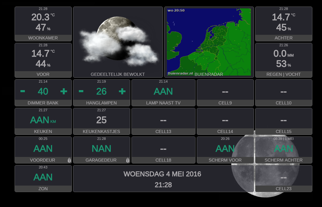

marcom
Joined: Friday 22 April 2016 21:10
Post by marcom »
G3rard, thanks for the help.
I already had weatherunderground implemented, but was using the wrong idx..
Now also the forecast is working perfectly ;) .
I have one question which i like to ask you, it doesn't matter in which browser i open the frontpage, i always get a vertical scrollbar..
Is there something i can do to remove this?
I changed the background of the frontpage, but i had the same problem using the original background.
The picture shown below is on a 10" tablet.
Thanks for your help.
Marco

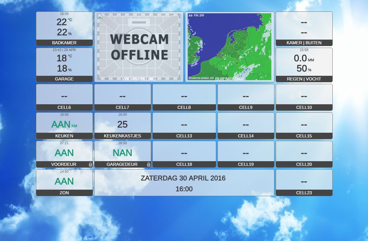

JuanUil
Posts: 500
Joined: Friday 22 May 2015 12:21
Domoticz version: 4.11083
Location: Asten NB Nederland
Post by JuanUil »
bizziebis wrote:It's a little embedde javascript inside the image tag which needs to be right. You need to put in "your camera url"&t= or ?t=
That last part is important because it will write a random time tag like t=752554822 behind the url forcing the image to be reloaded.
Hi There all. Great GUI which I allready use a long time.
Since last week I bought myself a Foscam FI9900P camera. I get a snapshot but no live stream.
This is what I have in frontpage html:
<div id="cell3"><img src="http://192.168.1.133:88/cgi-bin/CGIProx ... ture2&usr=my username&pwd=my password&t="
What am I doing wrong?
thnx for any help
Jan

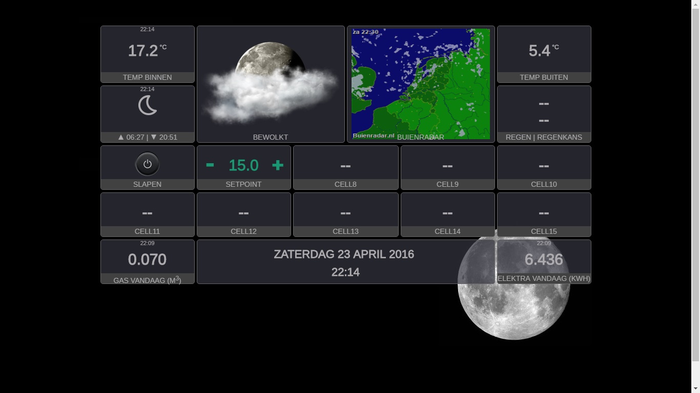

I use G3rard 's frontpage and would like to use the sunrise and sunset values in cell21.
However they don't show
In frontpage-settings.js i see that the var idx_SunState gets idx 66
However in my domoticz idx 66 is allready used. Is that a rpoblem or does the js file override's this idx ?
Do I have to change some settings in the default frontpage-settings of this frontpage ?
edit:
Sunset and sunrise do show now (large font) Icons don't show

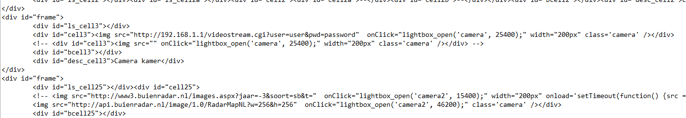

robertbrand78 wrote:Maybe stupid but who can just help me
I've used Gerard its front page and it works well
but would like to show CELL3 (next to the "buienradar") the weather icon
how do I get it done
:o
You have to change the code in frontpage.html for that cell. Now the webcam is coded in the html.
Then you can have a look at this post http://www.domoticz.com/forum/viewtopic ... 855#p83984.
Not using Domoticz anymore
robertbrand78
Joined: Friday 29 April 2016 21:46
Post by robertbrand78 »
:o
Oké Thnx fot the reply,
i fond the code but what do i do whit it if got the W.U. Working for the forcast in a other cell barro, temp, enz.
what code do i have to put in the <div id="cell3"><.... of the frontpage.html
Best regards Robert

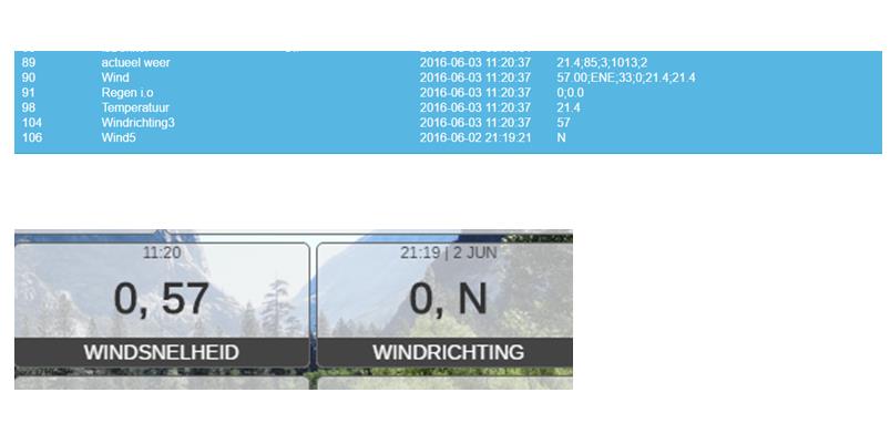

Post by curious »
I use weatherforecast.io to get some weather data
Some values such as windvelocity and direction come as a string like 296.00;WNW;86;0;12.2;12.2
For this string there is only one idx
How can I dsiplay only one subtype ?
Do I have to add some code (where) or can i use the subtype ?
Edit : found this tutorial https://www.domoticz.com/wiki/Virtual_w ... emperature
Will try to modify it

From the wiki I "borrowed"the code to scrape values from a virtual weather device.
when using the script to get the temperature it works fine.
Now I would like to get some wind-values from this virtual weather device. However I don't get the right values, and besides that I get a strange icon returned (see picture)
The virtual weather device returns 6 values : 277.00;W;65;0;11.6;11.6
After running the script idx104 has a string 0;277 and idx 106 has the string 0;W
I hope someone will check my code and checks what is wrong (and explain why)
Edit : Strange ? When checking the current status of both devices the values are displayed correct
