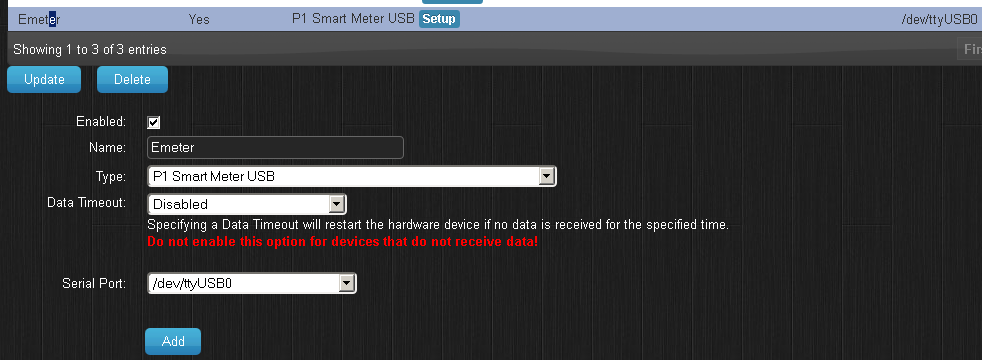

I have Landis+Gyr ZME120ACd and a IR-Schreib-Lesekopf from Udo
The IR-Schreib-Lesekopf is connected to the raspberry on /dev/ttyUSB0
I added the IR-Schreib-Lesekopf as an "SO Meter USB" on serial port /dev/ttyUSB0.
In the setup, I can change to Baudrate only to 9600 or 115200, my Landis+Gyr uses 300 Baud.
Where can I change this setting in to 300 Baud.

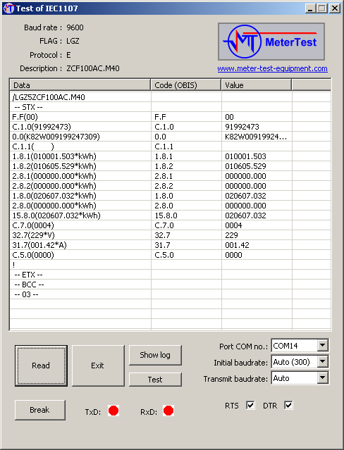

I have the same kind of problem with my Landis+Gyr ZCF120ABd. I won't get any reading from IR-Schreib-Lesekopf on my RPI.
Nothing pops up on my RPI. I have tested the IR-Schreib-Lesekopf with my windows laptop. It shows up and reads the data.
pi@RaspberryPi ls -l /dev/serial/{by-path,by-id}/*
lrwxrwxrwx 1 root root 13 Jan 1 1970 /dev/serial/by-id/usb-RFXCOM_RFXtrx433_A1YI4T4I-if00-port0 -> ../../ttyUSB1
lrwxrwxrwx 1 root root 13 Jan 1 1970 /dev/serial/by-id/usb-Silicon_Labs_USB-IR-Kopf_0092D858-if00-port0 -> ../../ttyUSB0
lrwxrwxrwx 1 root root 13 Jan 1 1970 /dev/serial/by-path/platform-bcm2708_usb-usb-0:1.2:1.0-port0 -> ../../ttyUSB1
lrwxrwxrwx 1 root root 13 Jan 1 1970 /dev/serial/by-path/platform-bcm2708_usb-usb-0:1.3:1.0-port0 -> ../../ttyUSB0
[b]pi@RaspberryPi ~ $ cu -l /dev/ttyUSB0 -s=9600 --parity=none[/b]
Connected.
- domoticz.png (28.66 KiB) Viewed 7737 times
Last edited by Dlanor on Wednesday 26 September 2018 20:25, edited 2 times in total.

I think for one reason is that the P1 serial port is opened with 9600 baud, Even parity, 7 bits
Maybe your serial protocol is different ?
what you can try:
install 'ser2net' and configure this that port 2000 is opening the right serial device, with the right parameters (in raw mode)
now when you connect from another machine to this port 2000, you should see the serial output
in domoticz, you can also setup a P1 meter with LAN interface
Maybe this will work
Probably later this year you will get a P1 Smart meter (i think everyone in holland will get one)
