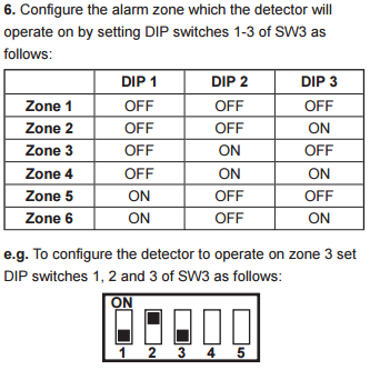

I have some of these working but they all transmit as the same device - how are other people using them. They don't seem to be unique?

Post by markk »
Mine are used as part of my existing alarm system so they are all set in different zones by using the dip switches. Set up like this mine all show different IDX in Domoticz.

Post by starfish001 »
Thanks Mark
I have mine all set as 110 - so that explains the problem
