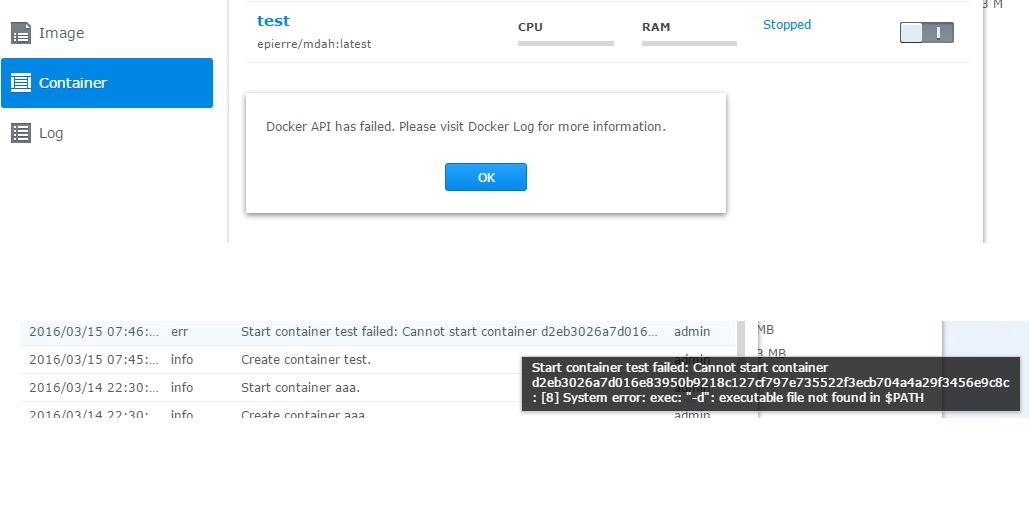

rafal wrote:second question how i can use these commands in docker on synology????:
Check running docker processes
docker ps
Stoping a docker process
docker stop mdah
Those are from the Synology interface, I give this for those running it under command line interfacer (CLI)
To modify the conf just edit config.json ... but take the image as I added the possibility to have a local conf in the latest image on dockerhub.
As I don't have the docker interface, I suggest this tutorial maybe removing the -it parameter:
http://blog.pavelsklenar.com/how-to-ins ... -synology/
It looks like you should put this in the "Docker Run Parser" parameters:
docker run --name=mdah --env DOMO="http://your_ip:8080" -it --rm -p 3002:3002 epierre/mdah"

Hello again :)
Thank You for answer and very good link now we know on synology in docker you commands can't working because:
Docker run supports the below parameters:
"d", "detach"
"e", "env"
"link"
"m", "memory"
"name"
"P", "publish-all"
"p", "publish"
"privileged"
"v", "volume"
in Synology in the "Docker Run Parser" i removed -it -rm but not working ;/ buuuuuut i find KItematic Docker for windows and all you commnad under CLI WORKING !! :) and i don't know what's next?????....take a look

ok let's try this:
docker run --name=mdah --net=host --env DOMO="http://your_ip:8080" -d -p 3002:3002 epierre/mdah

--net unsupported options ;/
i can give you access to my synology for test this command if you want ofcourse

some sait it should run, and without ?
docker run --name=mdah --env DOMO="http://your_ip:8080" -d -p 3002:3002 epierre/mdah

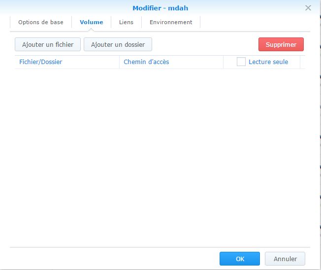

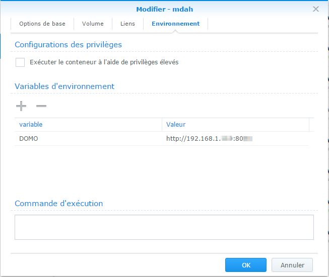

I sucessfuly ran the docker image on my synology box.
I used the assistant.
nothing on links page

Re: [MyDomoAtHome] Support thread
Post by rafal »
Thank You rgouyet it's works :)

epierre wrote:some sait it should run, and without ?
i can add, but if you want switch on is error about API
i delete -d and - p and both :) a still same msgbox :x about API
