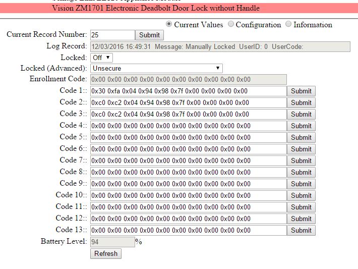

Hi. I recently bought a similar lock: the Vision ZM1701 (same as yours but without a handle). You will find the PIN code config in the OZW control panel but I cannot work out to set them.
In this link: https://github.com/OpenZWave/open-zwave/issues/657 it looks like the codes are stored in Ascii (although looks like hex?). Using the example in the link, I'd assume a PIN code of 1-1-1-1 would look like this: 0x61 0x61 0x61 0x61 0x00 0x00 0x00 0x00 0x00 0x00 but when I submit those digits, OZW saves them as: 0xc0 0xc2 0x04 0x94 0x98 0x7f 0x00 0x00 0x00 0x00
I don't get it :(
Can anyone shed some light on this please?

I asked the same question on the OZW forum and it seems ASCII for "1" is "0x31". I have tried specifying the following string for PIN 1-1-1-1:
0x31 0x31 0x31 0x31 0x00 0x00 0x00 0x00 0x00 0x00
However, this still doesn't work.
Is there anyone here using Z-Wave locks with Domoticz that might know how to setup PIN codes for this device please?
