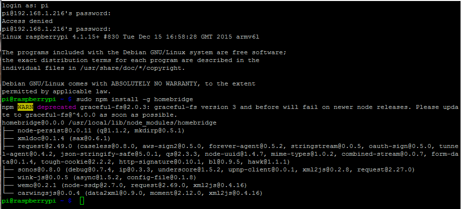

Great plugin, but i don't get it to work. I have tried everything. Its seems that i haven't got a /usr/local/lib/node_modules/homebridge/bin/homebridge, I only got /usr/local/lib/node_modules/homebridge/. I did follow the installation guide on the first post?
Can someone point me into the right directions :)

Sounds like homebridge failed whilst compiling... run:
sudo npm install -g homebridge
...again, and copy / paste any output into your reply.

this is when I do "sudo npm install -g homebridge'

K - looks to have installed ok... Use
sudo find / -name homebridge
...to find out where it's put the binary.
