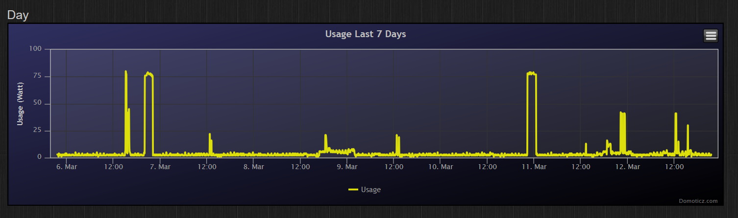

Good evening, I have an issue and cannot find a solution.
I have an powermeter with a led pulsing 1000 times/kWh.
I installed an optical sensor connected to a ESP07 running ESP easy.
I have a graph with a point every 5 minutes, but the value in watts is wrong (60 times too small and no decimals).
I created a second sensor in domoticZ / ESP Easy with the same physical sensor.
Now the value in watt is OK but I have only a value per hour.
How can I configure domoticZ to have a sample per 5 minutes with the right value ? What's wrong ?
thanks in advance to all

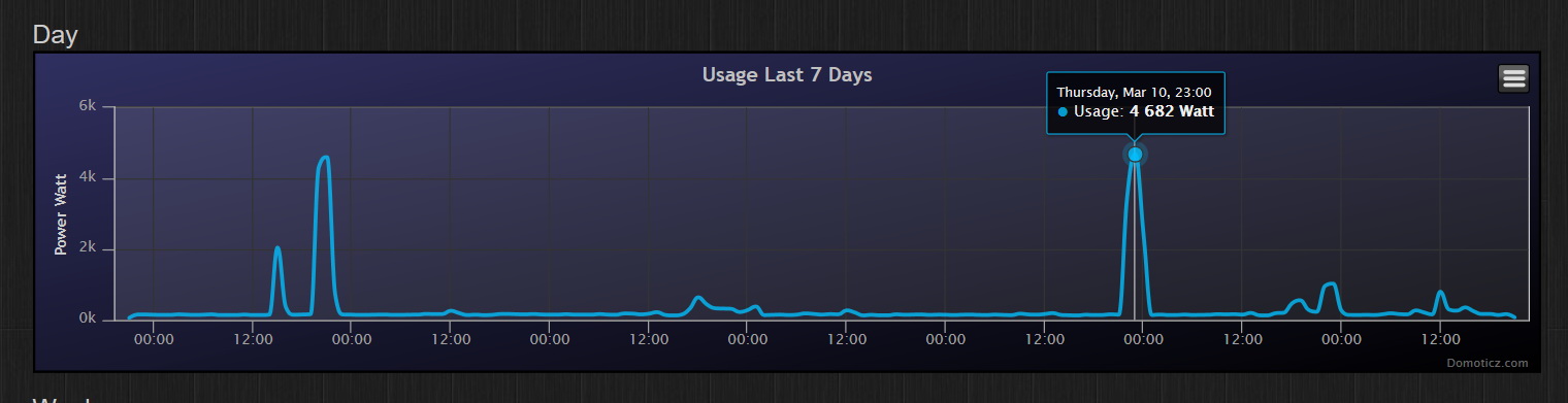

Sorry for mixing figures.
The yellow is the 5 minutes sample rate with wrong values and the blue the 1 hour sample rate with real values

Thanks for your answer.
Does it exist a solution to have on the blue curve 1 sample every 5 minutes, in place of 1/hour, just to have enough pulses for an acceptable precision ?

Re: Electricity meter issue
I don't think Domoticz supports this unfortunately.
Though I'd like to have such feature too. Generally I have ~10-20 pulses per 5 minutes. Multiply this by 12 (60/5) and this will give a wattage with good enough precision at least to see when energy-hungry devices (fridge, oven, boiler etc) switch on and how much power they take.
Count per hour is just too low resolution and limits usefulness of reports.
Since its PWM, "instant load" could be approximated as:
(Instant load at this pulse in Watts) = (Wh per pulse)/(hours since last pulse)
Obviously it will be as precise as pulse frequency - actually it will be more precise when power consumption increases (and when it actually matters most).
Edit: actually pulse meter indicator is PWM-like device, and there is nothing "crude" about it, it actually can provide quite accurate data.gordonb3 wrote:The graphs are a nice gimmick to show trends but you should not expect them to show any real values, particularly with hardware that shows such crude information.
... and as a proof that its totally possible to make simplest Wh pulse meter to act as accurate Watt-meter I've made a script, which you can see in its dedicated thread - viewtopic.php?f=32&t=11315
