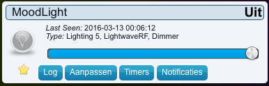

Screen Shot 2016-03-13 at 01.06.59.png (25.92 KiB) Viewed 6891 times
I've tried several different ways, yet none made it work
Anyone who can tell me how to make this work in frontpage?
