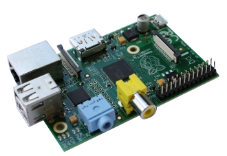

My PI is a Raspberry Pi REV 2 Model B UK version (blue audio port)
Uname -m gives me a armv6l
