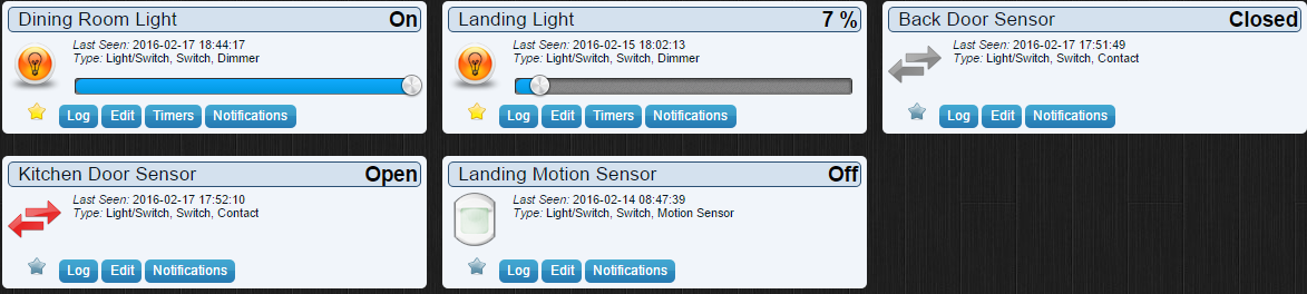

I'm new to Domoticz but have recently set it up on an Ubuntu server.
I used Imperihome previously with Vera so naturally, I went straight back to it and it installed very easily with Domoticz.
All my lights work without issue.
However, I previously used Composite security devices in Imperihome that grouped my door sensors (contact sensors) into one device within the app.
I can't seem to do that now.
Domoticz sees these sensors as switches, so Imperihome sees them as switches also. Is this normal for Domoticz or have I done something wrong?
Is there anyway to get Imperihome, by way of MDAH, to recognize these as door sensors?

FionnanBurke wrote:Hi,
You're right! PIR's appear as motion devices and can be added as an individual security sensor widget or associated with the composite security widget but for some reason, door/window sensors cannot. They appear as switches only in imperihome and can't be added as either type.
Might be one for epierre....
EDIT: Slight correction.. you can add the contact sensor as a light switch and then change the icon to something more meaningful but you still cannot add these devices to the composite security sensor.

raym wrote: You're right! PIR's appear as motion devices and can be added as an individual security sensor widget or associated with the composite security widget but for some reason, door/window sensors cannot. They appear as switches only in imperihome and can't be added as either type.
Yes, when I add the contact switch as a light, I change the type to Contact and the icon changes to something more meaningful, not a light bulb.
I have a few wall mounted tablets running Imperihome but I liked having a tile to show if any doors or windows are open as its useful to know before leaving the house for the day.
It would be great if Epierre could give his 2c on this. But as I said before, Imperihome working with Domoticz is awesome. Great work
Hello, thanks appreciated !
As discussed with raym, I could move some devices from switches to DevLock but I would need to find something that I could detect it to be it. In domoticz, do you use another icon on that switch ?
currently if this is a door/window, if you say in DZ the switch is a door lock, I map it in IH to Door Lock.
IH recognized as a security system those : DevDoor, DevFlood, DevMotion, DevSmoke, DevCO2Alert

Thanks epierre. Yes, as mentioned above, you can use the standard lock sensor widget on this device and it works OK - but no last tripped status yet ;).
Does that help?

epierre wrote: Hello, thanks appreciated !
Hi Epierre,
Thank you for this, I was not aware that changing this to a Door Lock works. I just changed this and the composite switch in IH works now.
It doesn't show last trip time but for me, that isn't a priority. I've attached a screenshot of my domo setup looked before changing them to door locks.
