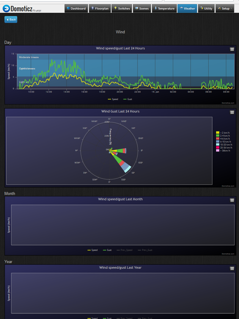

I have some problems with the Domoticz program on my Synology and I hope one of you or Jumbotroll can help me.
It is about the picture for the windmeter which since a few months is not displaying a graph for the month and year view anymore.
The behaviour is as folllows at the moment:
Domoticz Wind.PNG (243.47 KiB) Viewed 2706 times
I would like to have see the graphs for the mont and year also again as it worked previous.
Can anyone point me out what to do to get this to work again?
I'm running Domoticz version 2.0.4618-7 from Jumbotroll which I downloaded from http://www.jadahl.com/domoticz_beta/?arch=x86
I hope for some answers.
Best regards,
Bert
Best regards Bert
Synology DS1517+ - DSM 6.2
jumbotroll
Posts: 793
Joined: Tuesday 13 January 2015 14:36
Location: Oslo,Norway
Re: domoticz in synology as package! Available now.
Post by jumbotroll »
@bertbigb
I have no opportunity to test this , but is this error only on Synology ?
If you like the work I do for synology and domoticz, I appreciate a donation.
https://paypal.me/Jumbotroll
Jumbotroll
