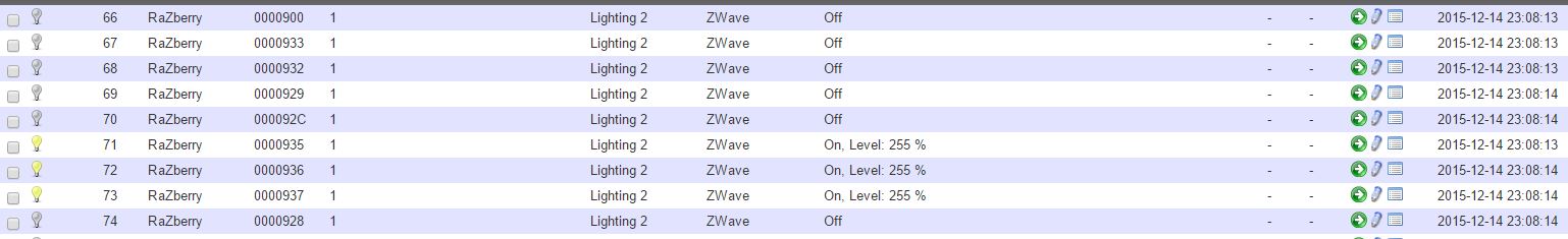

I have, after adding the Smoke detector 8 devices, no clue where they all are for but none of the devices is reporting the temperature.
Someone some advise here?

You are missing one with id 0901 (where 09 is the node id).
Why? I don't know. I have 6 such smoke detectors wich are mainly used for their superb thermometer (with aeotec z-stick).

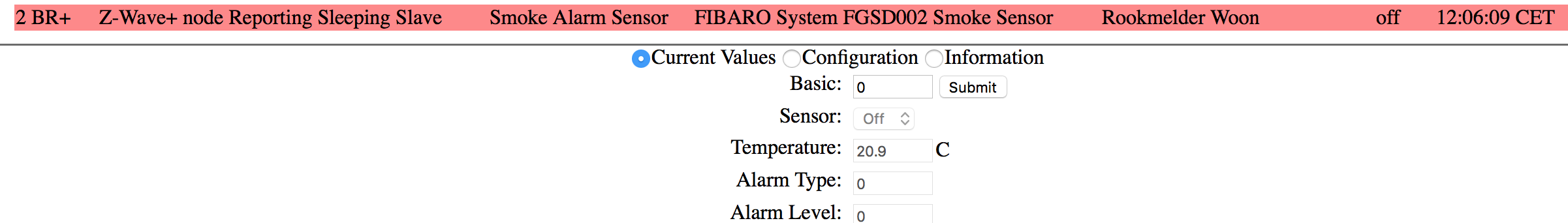

In control panel, i can see the temp value, the sensor field is set to off (cannot change it)

Try to update the temp frequency, but this stays on 10s. Unable to update the config.

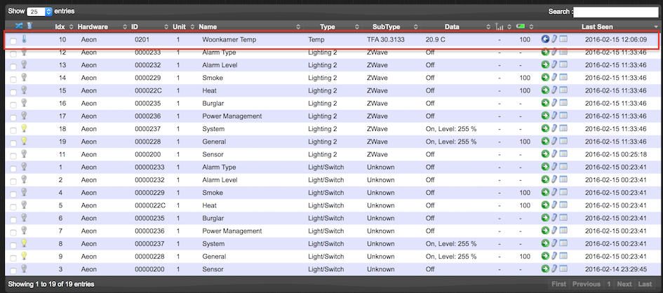

After a manual install, i did not see any changes of, stil no temp node. i installed the beta release and suddenly i noticed the temp sensor as node
Schermafbeelding 2016-02-15 om 13.23.50.png (326.91 KiB) Viewed 4531 times

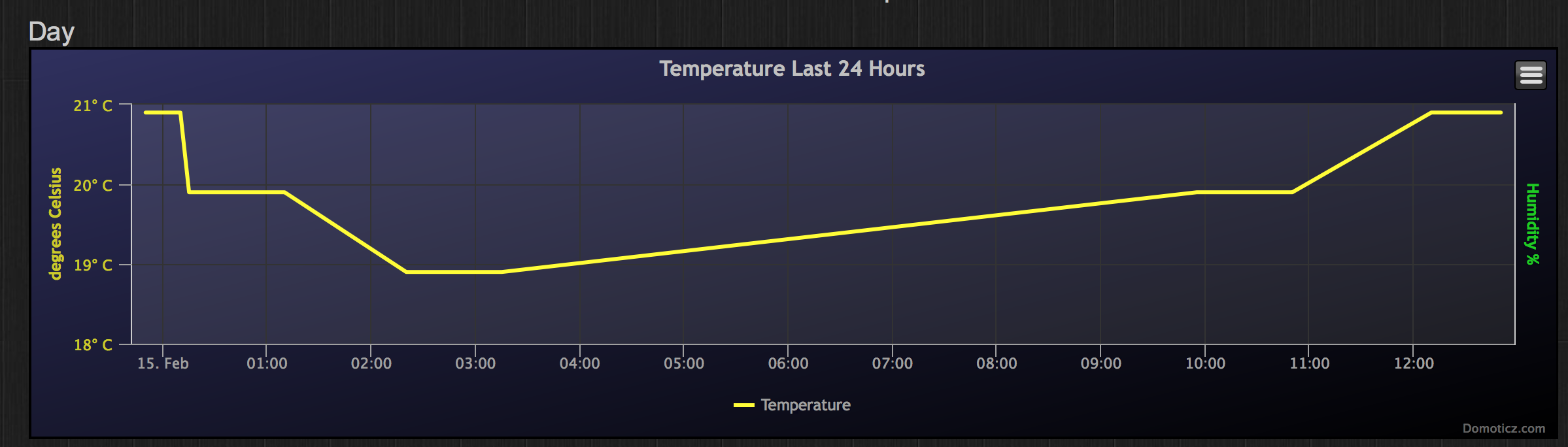

Only the previous nodes, are still visible. Changing back to stable release, because i could still not adjust the smoke detector config settings, the temp value was still reporting every 5 min. Only during the night it stopped and at random points it is reporting.
Schermafbeelding 2016-02-15 om 12.53.52.png (333.79 KiB) Viewed 4531 times
This is not because of the 1 degree temp change, because from time to time it reports every 5min and sometimes not for a few hours.
