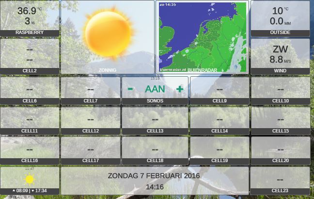

I´ve not tested yet but you are using a selector. G3rard describes to use a switch (https://github.com/gerard33/frontpage).
I see you are using the default Mediaplayer icon. On this page (https://drive.google.com/folderview?id= ... sp=sharing) you can find a beautiful Sonos icon ;)

@luckydoggie, indeed use a normal on/off switch. The js code is looking for an On status, which the selector button doesn't have, so you won't see the buttons in the cell.
