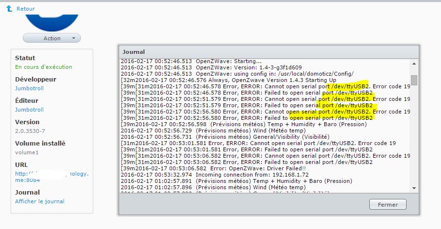

Now i meet a new problem ,
I plug AEON Stick on my Synology
Is there any easy way to know what is it's usb device mounted name (usb0 , usb1?), When i want to manage it nothing appear, what i get wrong ?
here is lsmod and dmesg |grep usb

Some news here, i still try to plug my AEON Stick gen5 , with UsbSerialDriver V3.0.9
and Fail to open usb port
I think there is a problem with detect AEON Stick ?
Thanks for help
Thanks for help
