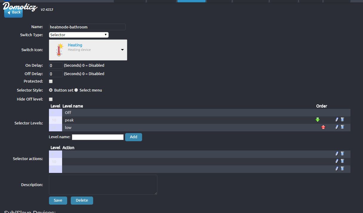

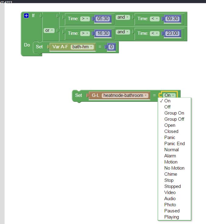

I have created a selector with 3 states (Off, peak and high)
But when I want to set it from within Blockly these states are not available.
Already restarted domoticz, still not showing.
Does anyone know why?

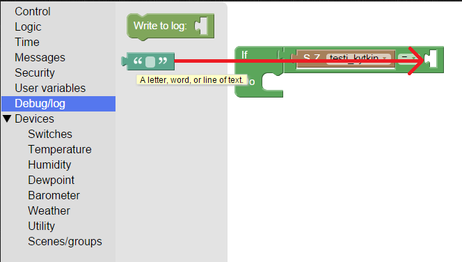

Re: Mode-selector / multistate device
Use text blocky instead of switch mode blocky.elmortero wrote:Does anyone know why?

That worked.
