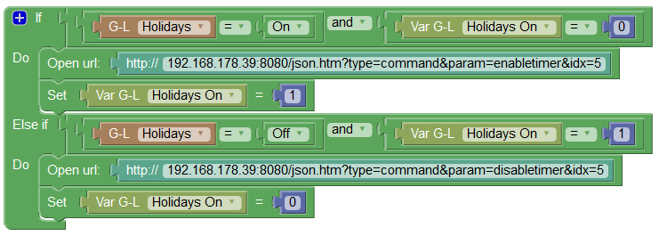

Could you elaborate on if and how to make these json URL's work with the blockly? I tried the setup in the image below:
Event with json.PNG (26.58 KiB) Viewed 10705 times

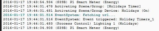

It changes the state of the control variable. In the log I can see it tried to fetch the URL:
but there is no change of state in the timer list. If I try the same URL from my browser it works fine.

Sorry, i can't tell you why the blockly is not working because i don't use them. I only use (bash/python) scripts to fire the json calls.
