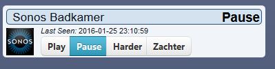

Also proponent for such a silent future. In my case, the Sonos switch status used in Domoticz should always follow the state of the Sonos player, even when the player is controlled outside of Domoticz
Will try the workaround via the uservar
See screenshot below, these buttons should always follow the actual state of my Sonos player.
