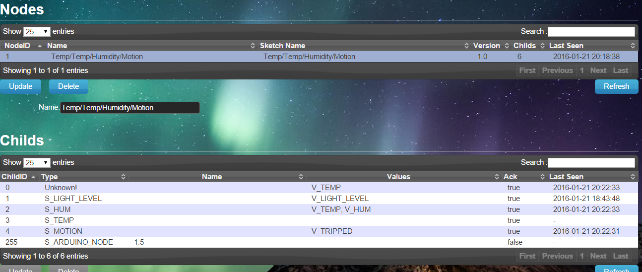

Post by remb0 »
I use an mysensor with: motion, ds1820 (temperature), dht22
everything worked fine (the ds1820 was connecter on my hot water pipe. but since a few weeks I do not get new values.
is something changed so my sketch isn't compatible? who can help me with controlling the sketch?
Not knowing if it's a bug or something on the script.
2016-01-21 20_23_07-Domoticz.png (350.02 KiB) Viewed 1410 times

HarryDutch
Posts: 8
Joined: Sunday 03 January 2016 11:57
Re: 5-in-1 sketch corrupt after updates?
Post by HarryDutch »
The value of CHILD_ID_TEMP and CHILD_ID_HUM is the same (2). Give one of the id's a another value.
I see that you are now using the MySensors beta library. Things are handeled different when you are using the beta. For example, every reference to "gw" needs to be removed and so on (for example you now write "sleep" instead of "gw.sleep". You better have a look at one of the example sketches in the new library to get the picture. Could you post the latest sketch you're using?
