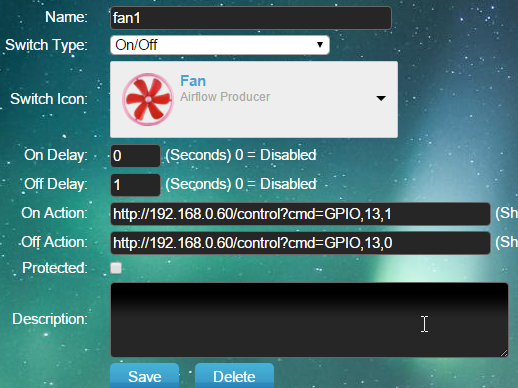

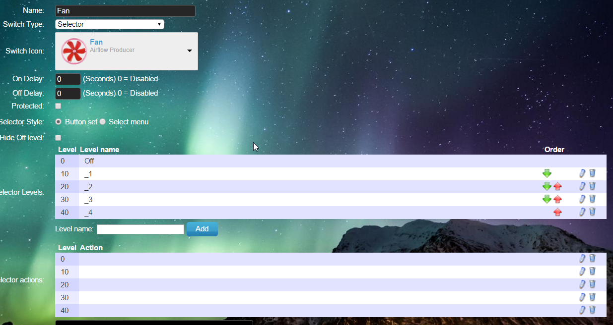

I habve 4 ventilation buttons programma like the screenshot:
they send an on command, and after a second an off.
so the nodemcu with easy esp pushed a button on a remote to set it ON (like I pressed the remote controller) and after that it goes the same for the off command.
1=on 0 is off. when I will use only my selector I have to make an lua like:
But when I press the selector the lua won't push my buttons.
what's wrong here?
I thought I had it working this way before, but not sure anymore..
I hope I do something wrong, but an action like on/off as in a normal switch (with off delay) would be better then a lua I think. Is this possible?
