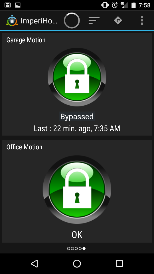

raym
- Posts: 81
- Joined: Tuesday 03 November 2015 5:07
Re: RE: Re: [MyDomoAtHome] Support thread
Thanks for the reply. Could you explain in more detail though please?epierre wrote:it takes only the time of refresh you can set in the imperihome parameters.raym wrote:Hi guys, what would it take to show last tripped/updated time for motion sensors?
Please see screen shot attached...
I have "Garage Motion" set up in a Vera system. I see the time the sensor was last tripped under the security widget.
In my DZ/mdah setup, I have a similar sensor called " Office Motion" which shows either "ALARM!" when tripped or "OK". I don't ever see last tripped info. When I tap and hold the widget and tap "Details" - the last tripped info on the details page reads: "unknown".
Thanks.
- uploadfromtaptalk1454360461621.png (76.69 KiB) Viewed 2564 times
- epierre
- Posts: 522
- Joined: Wednesday 05 March 2014 13:16
- Location: France
I'll have to take a look, just remember the on/off is the triggering in Vera as there is no difference of this sort in Domoticz. Maybe I'll need your domoticz.db to see if they are both the same device or not.
I don't remeber if this was you, but someone asket about using vera as a "dongle", I've started the article

raym
- Posts: 81
Thanks. Understand about on/off being a Vera thing and I"m not interested in that - just the last tripped time. I'm transitioning from Vera to Domoticz and will eventually switch it offepierre wrote:Hello,
http://www.domoticz.com/wiki/VERA
Let me know if you'd like my db or anything else to assist you.
Than you.

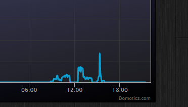

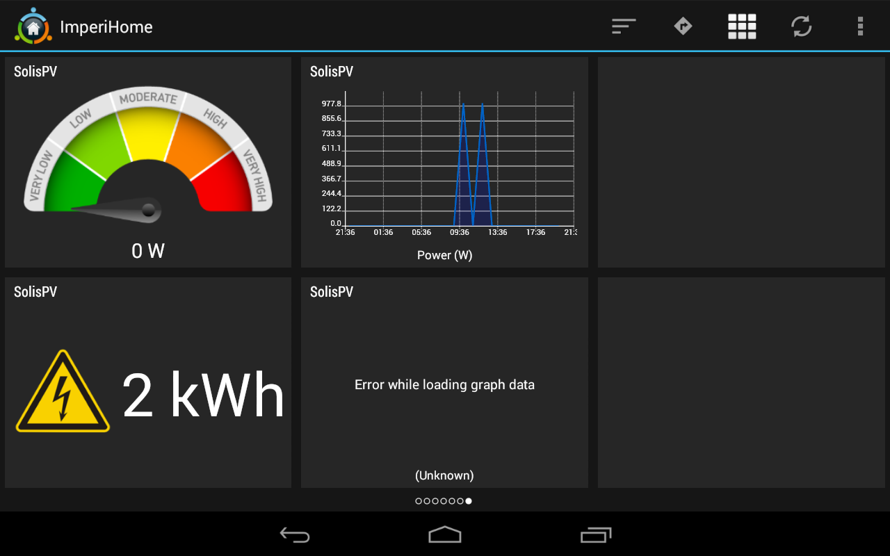

I'm having a small problem with one of my power graphs in Imperihome, connected through MDAH to Domoticz. Running latest versions of MDAH, Domoticz and Imperihome but I've noticed this for a few months now.
The above screenshot shows the widgets for my solar panels. On the left hand side (instant power, top left and daily kWh bottom left) and then in the centre are the graphs (centre top, instant power and centre bottom, daily kWh).
The first problem is that the instant power graph seems to have a very low resolution (only very few data points) whereas the data in domoticz is captured every 6 minutes or so, and domoticz shows it as a detailed graph (below): I have other graphs in Imperhome (e.g. temperature) that are working fine and have a good resolution.
Secondly, the daily kWh graph widget is created ok, then when clicked on, it results in an error.
Any help would be appreciated.
Stimpy
Stimpy

@stimpy I would need your domoticz.db but a fresh one for the data graphs, so wait till I have resolved my computer issue before sending.
