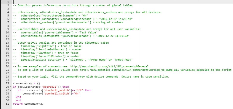

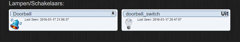

Hello I am trying to make a LUA script
my door bell but it gives an error can somebody pushes me in the right direction
the error log
2016-01-18 08:32:08.681 EventSystem: reset all events...
2016-01-18 08:32:09.335 Error: EventSystem: Lua script did not return a commandArray
2016-01-18 08:32:16.041 Error: EventSystem: Lua script did not return a commandArray
2016-01-18 08:32:16.145 Error: EventSystem: Lua script did not return a commandArray
2016-01-18 08:32:16.244 Error: EventSystem: Lua script did not return a commandArray
does anyone know the solution

- jvdz
- Posts: 2333
- Domoticz version: 4.107
All event scripts should contain this at the top of the script:
and this at the end of the script, returning the wanted change commands:
Jos
return commandArray

- G3rard
- Posts: 669
- Joined: Wednesday 04 March 2015 22:15
- Target OS: -
- Domoticz version: No
Use
devicechanged['Doorbell']
So with a capital D as you are using looking at the screenprint you enclosed.
The names are case censitive.

G3rard wrote:Use
oke G3rard
if (devicechanged['Doorbell']) then
if otherdevices['doorbell_switch']=='Off' then
commandArray['doorbell_switch']='On'
return commandArray
2016-01-18 09:58:23.880 Error: EventSystem: [string "-- ..."]:30: 'end' expected (to close 'if' at line 26) near
2016-01-18 09:58:25.440 Error: EventSystem: [string "-- ..."]:30: 'end' expected (to close 'if' at line 26) near
it seems that the doorbell is not local

- G3rard
- Posts: 669
- Target OS: -
You have to add an extra end between end and return commandArray.

- Posts: 30
- Joined: Saturday 27 December 2014 15:50
- Domoticz version: V4.20078
- Location: Menterwolde,The Netherlands
Yes no errorG3rard wrote:You have to add an extra end between end and return commandArray.
but when pressing the bell
and the switch does not turn on
the log
2016-01-18 10:07:00.260 Error: EventSystem: [string "-- ..."]:26: attempt to index global 'devicechanged' (a nil value)
2016-01-18 10:07:00.517 User: gebruiker initiated a switch command
2016-01-18 10:07:00.534 Kodi Notification (192.0.0.0:9777, TTL 1): Doorbell, Doorbell pressed, Icon /home/pi/domoticz/www/images/doorbell48.png
2016-01-18 10:07:00.537 Notification sent (kodi) => Success
2016-01-18 10:07:00.544 Executing script: /home/pi/domoticz/scripts/domoticz_main
2016-01-18 10:07:00.519 (rfx) Chime (Doorbell)
2016-01-18 10:08:00.581 Error: EventSystem: [string "-- ..."]:26: attempt to index global 'devicechanged' (a nil value)
2016-01-18 10:09:00.282 Error: EventSystem: [string "-- ..."]:26: attempt to index global 'devicechanged' (a nil value)
2016-01-18 10:10:00.486 Error: EventSystem: [string "-- ..."]:26: attempt to index global 'devicechanged' (a nil value)
26 if (devicechanged['Doorbell']) then

- G3rard
- Posts: 669
- Target OS: -
Please share the complete LUA script you are using for the doorbell. Seems to be something strange in it.
Not using Domoticz anymore
- Posts: 30
G3rard wrote:Please share the complete LUA script you are using for the doorbell. Seems to be something strange in it.
okay here it is

- G3rard
- Posts: 669
- Target OS: -
@benotje, did you save the LUA as a Device in the Event page?
The pulldown on the right top now probably says All. Change that to Device and save the LUA script.
- Posts: 30
No I did not but this does not helpG3rard wrote:@benotje, did you save the LUA as a Device in the Event page?
I can not specify LUA IDX: 104
Top Thanks for your help
Now again I can continue, I am happy with it
